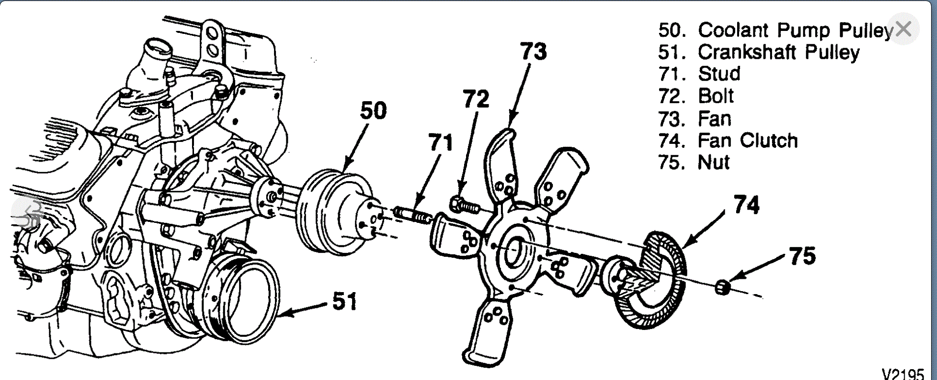

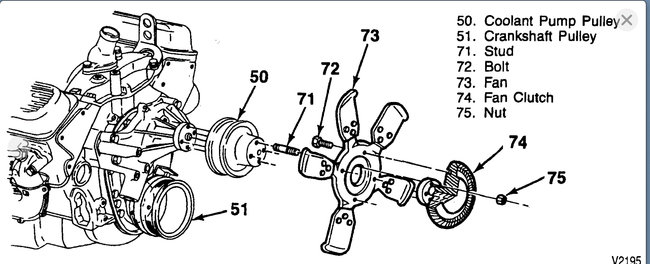

Let me know. Also, the pulley and fan bolt right to the water pump. Let me know if you need help with that. I attached a pic below of how it goes together.
See pic below.
