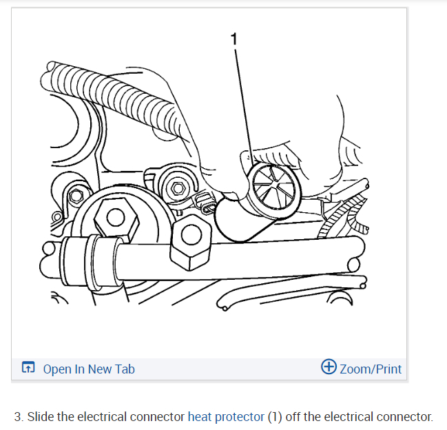

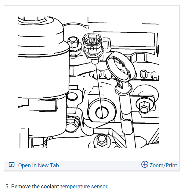

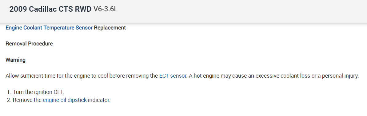

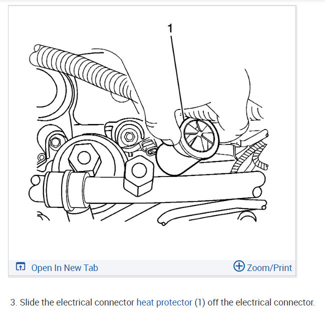

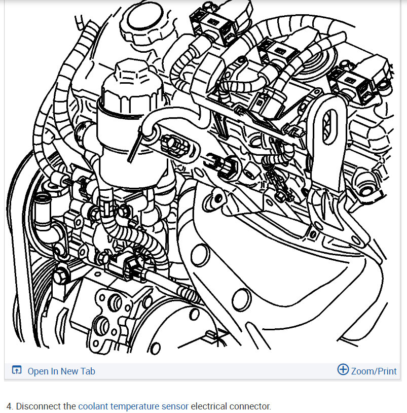

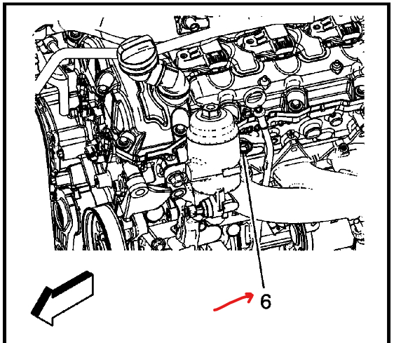

Yes, the system uses the engine coolant temperature sensor to monitor the engine temperature and turn the radiator cooling fan on accordingly. If the connection is broken the PCM will turn the fan on as a default to help protect the engine. I would swap the engine temperature sensor out to help fix the problem. Once completed start the engine and turn the A/C system on and wait about 1 minute and the fans should come on. Here are the instructions on how to change the sensor out correctly. Check out the images (below). Please let us know what happens.
