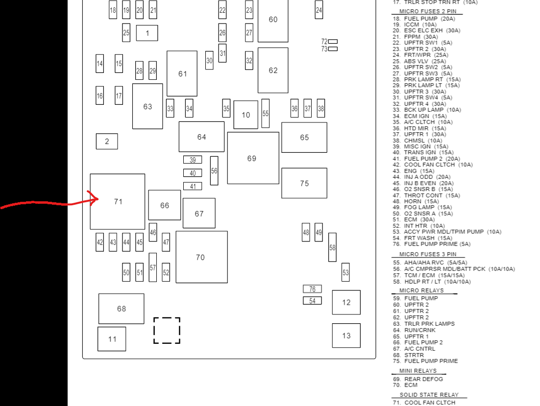

It sounds like the cooling fan relay is stuck on, I would remove it temporarily to see if the noise stops and if so, install a new relay. here is the location so you can check it out. Check out the images (bBelow). Please let us know what happens.
