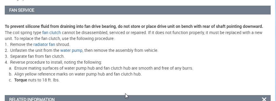

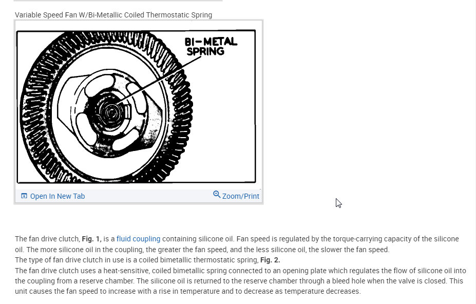

I attached a document that helps explain how this works. Basically, there is a spring that as it heats up the silicone oil causes the fan to spin faster.
Unfortunately, it looks like there is an issue with the clutch because this is one of the more common failures with these fans.
Here is a guide that will help explain this. Let me know if you have questions.

Okay. I guess I should have clarified if this was a change in operation. Yes this fan is run off of a metal spring that once the temp reaches that point, it engages the fan. Then as this spring gets hotter the fan goes faster.
If this is how it is operating then it is normal. However, if the fan is making a loud roaring noise all the time, then most likely it has failed and needs replacement.
