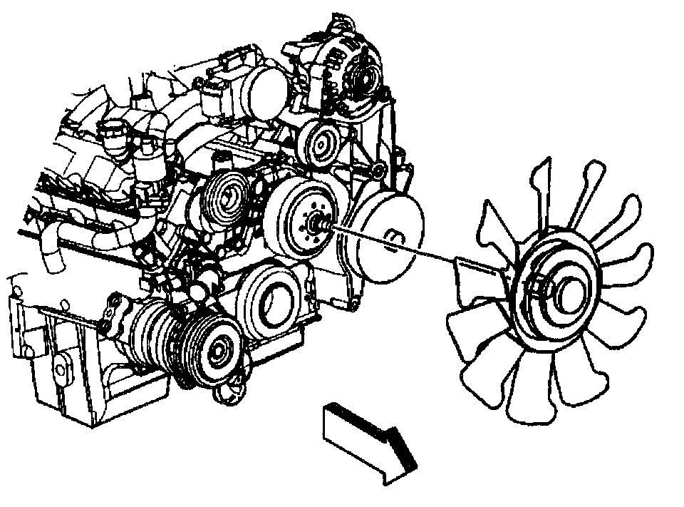

If you determine the clutch is bad, here are the directions for replacement. The attached pics correlate with these directions.
Fan Clutch Replacement
- Tools Required
- J 41240 Fan Clutch Remover and Installer
- J 41240-5A Fan Clutch Wrench
Removal Procedure
picture 1
1. Remove the upper fan shroud. Refer to Fan Shroud Replacement - Upper (IMIO M74) or Fan Shroud Replacement Upper (WIM74).

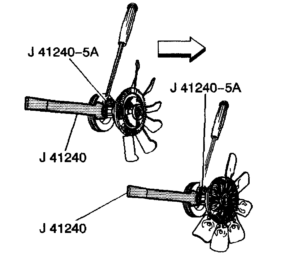

2. Install the J 41240 to the fan clutch.
picture 2
3. Remove the fan blade.

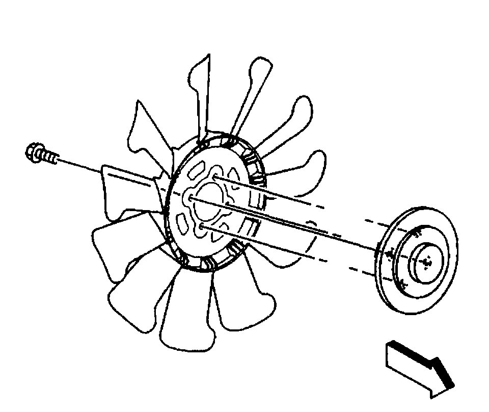

4. Lay the fan blade face down on a workbench.
picture 3
5. Remove the fan clutch bolts from the rear of the fan blade.
6. Separate the fan clutch from the fan blade.

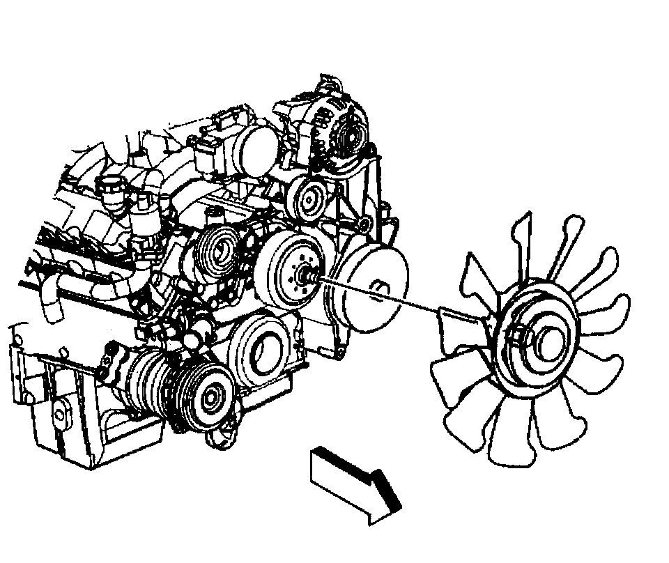

Installation Procedure
picture 4
1. Install the fan clutch bolts.
2. Install the fan clutch onto the fan blade.
Notice: Refer to Fastener Notice in Cautions and Notices.
3. Install the fan clutch bolts.
- Tighten the bolts to 23 Nm (17 ft. lbs.).
