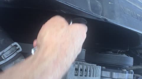

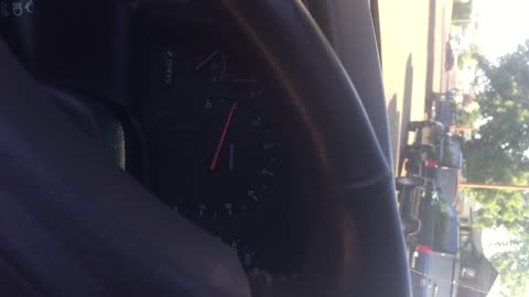

I finally got it to download. It’s 18°C day today. Not too hot. Here are two videos taken one after the other:
Aug 6, 2019 at 8:40 AM
What brand of fan clutch did you install? I would get an AC Delco unit from rock auto. Also can we remove the serpentine belt and start the engine to make sure the noise goes away? Also check the bearings for the tensioner as well. Let me know.

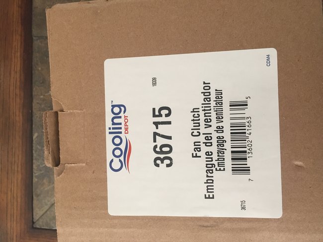

Here is photo of part. I’m confused, if I remove serpentine belt there is no chance that the fan will turn at all is there because it’s not hooked up anymore. Is that not correct?
Aug 6, 2019 at 11:25 AM
Correct, I just want to make sure the noise stops to rule out any internal engine noise. That fan clutch I would take off and install an AC Delco unit from RockAuto.com your problem should go away.

Thank you . You have been very helpful. It’s my daughters vehicle and I still work. I’m not sure when I will be able to finish it. We will probably take it to a shop. I don’t have the know how or tools to start tearing everything apart to eliminate each item. This is not an AC Delco. I just bought this at my favourite parts store that I always deal with. Is it possible that I have a defective one?
Aug 7, 2019 at 7:19 PM
Yes it is possible that you got a bad one, let me know what happens when you can.
