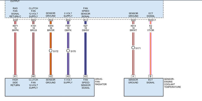

I was in Sioux falls, SD the other day and the fan clutch stuck engaged (could not move fan by hand with engine off) it was 30° out. Now I am home back in Arkansas and it is 65° out and the fan can be moved by hand.
Nov 30, 2018 at 12:08 PM
Good afternoon,

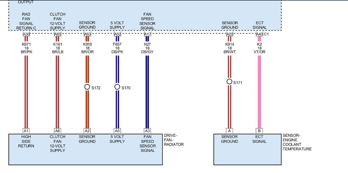

The clutch is controlled by the PCM. Once it sees the signal from the coolant sensor, it will turn on or off the clutch depending on load and temperature.
There was a TSB on updating the program for the fan clutch.
I attached the TSB and a wiring diagram for you to view.

Customers that operate their vehicle with a snowplow attached to the vehicle may cause the airflow passing through the radiator to be disrupted resulting in higher than normal engine temperatures The 6~7L Cummins ECM is equipped with software that can fully engage the fan clutch to allow an increase of airflow through the radiator Customers can initiate the fan clutch operation by performing the following button sequence
NOTE:
2007 early 2009 models were not originally equipped with the fan clutch software however, recently released software does include this enhancement Ensure that the ECM software is at the latest level and if not, flash the ECM Refer to Service Bulletin 18-020-10 for additional information
1.Turn the ignition key to the run position or start the truck
2.Simultaneously press and release the Cruise Control "Cancel" button/lever and the "Exhaust Brake" button. Repeat this sequence four times within five seconds. The chime will sound twice as an audible indicator that the function is engaged
3.To disable the function, repeat the same procedure The chime will sound four times as an audible indicator that the function is disengaged
