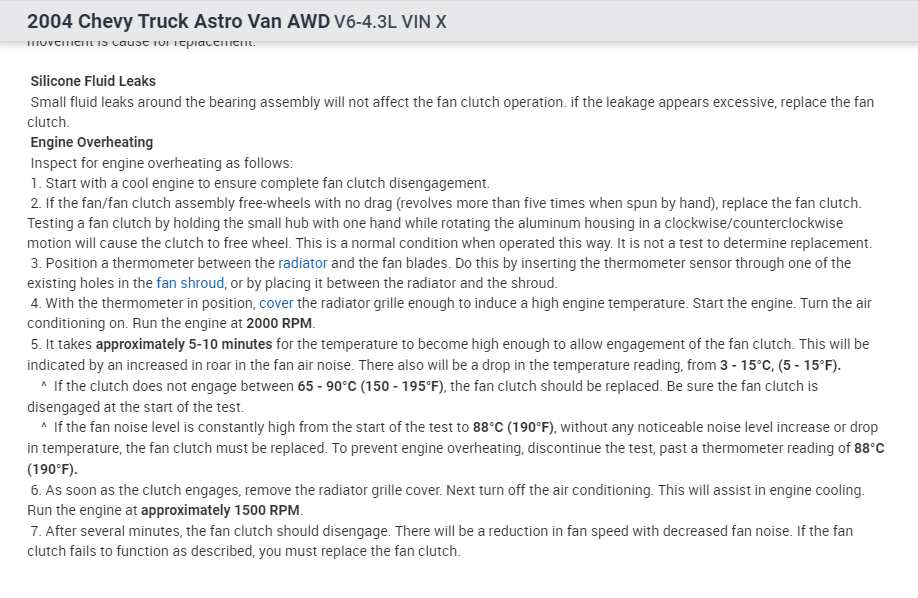

If it is getting that hot at highway speed, something other is likely the problem. Also, that temperature would cause the fan to make more noise.
So, now I have several different thoughts. First, I suspect the thermostat was inspected or replaced, correct? Also, by chance do you have a live data scan tool or access to one? If you do, can you provide me with the short-term fuel trims when the engine is at operating temperature? Also, could you let me know how the oxygen sensors are reacting at operating temperature as well?
Last, do you notice any of the following:
Any smoke from the exhaust other than normal steam?
Any odd odors from the exhaust that could indicate a fuel mixture issue?
Has anyone checked for a partially plugged catalytic converter?
Do you hear any rattling from the catalytic converter or hissing sounds?
Has the radiator been flushed or inspected?
When the engine is excessively hot, have you checked to make sure none of the radiator hoses are partially collapsed?
Sorry for so many questions. The idea that it runs hot where you are located at highway speeds sounds like something is causing it other than the fan.
