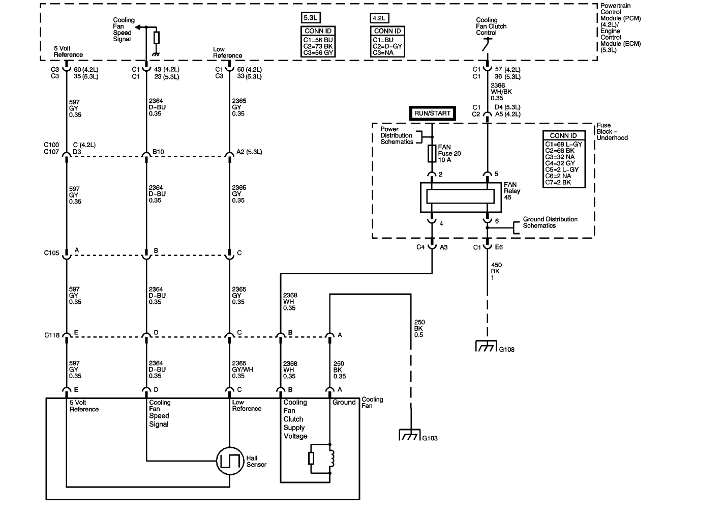

I replaced the fan clutch twice on my vehicle. The second time was about three weeks ago. now and it is still showing service engine soon. I checked the wires that plugs into the fan clutch and I am only getting one out of five that works. What is the part called that plugs into the fan clutch? I know it is a harness, but I cannot get a full name on it. And would I have to rewire the whole thing?

There should be a ground (black wire) 12 volt feed from the fan relay (White wire) on the clutch power side. The other 3 wires are for the fan sensor. Solid gray wire should have 5 volts with the key on. Gray wire with white is a ground inside the ECM and the Dark Blue wire is a signal feed to the PCM.
With the key on and a cold engine the only wires that will show anything are the grounds and the 5 volt feed.
Have you checked the fan fuses and the relay?

I'm getting code p0526 I tested the white wire and getting a good signal. But I'm getting nothing from the other one. I checked fuses and relay and they're all good
Oct 11, 2017 at 2:08 PM
STEVE W.
  • 15,113 POSTS
OK that is a failure on the sensor side of the system. Check for 5 volts on the Solid gray wire, and a ground on the Gray/white wire.

OK test the wires above for powers and grounds. Should have battery voltage on White, 5 volts on the Gray wire and connection to ground on the Gray/White and Black.
There are a few connections in the lines so it's possible one or more have corrosion.
Testing them should show what's going on.

I tested the wires with my multimeter and all wires are good... Could it be just a faulty fan clutch. This is the 2nd one I put in now

It could be but I doubt it. I think you will probably need to get an Oscilloscope to check if the signal from the clutch is actually getting up to the PCM.
Does the fan seem to work OK and you just get the error or is it locked on high?
You installed the new one, cleared the code and it came right back correct?
There is a TSB on these where the wiring harness chafes on the bracket and causes them to lock and throw a code. This isn't the issue as the cable would have come with the new clutch.
There is also a TSB that reprograms the fan operation but it doesn't apply to yours.
So either there is a bad connection in the signal wires to the PCM (doesn't take much) or the PCM itself is messed up.
It might be time to take it to a dealer or good shop and have them verify where the issue is with an OEM level scan tool.

Has to be a signal issue then. A VOM won't read the signal as it's a digital pulse not a sine wave or fixed voltage. Have you tried a continuity test from the connector back to the PCM? The dark blue and gray w/white would be the two to check.
Beyond that you need a scope or factory scan tool to read the fans duty cycle.
It's possible the old fans failure sent a power surge up the line to the PCM and the input is cooked but no way to tell that without seeing what the PCM is actually seeing from the fan.

I ended up taking it to the dealer and found out the problem. There was a broken wire inside the covering. $215 later fan is working. Some thing I've missed and was very hard to see But i have 2 more codes popped up when they did it p014 and p0420. Cam shaft positioning sensor I'm gonna do myself just need to find the time. But the other on the catalytic converter sensors. Should I go the easier route of replacing the 02 sensor first. The dealer quoted me $1684 before taxes.
