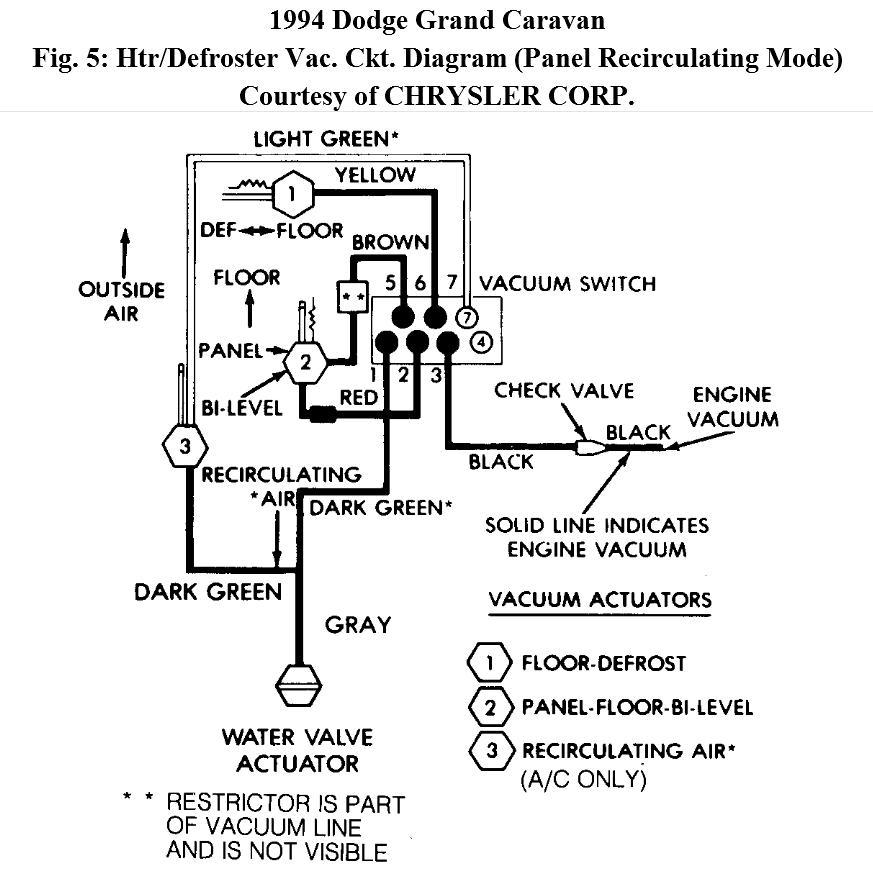

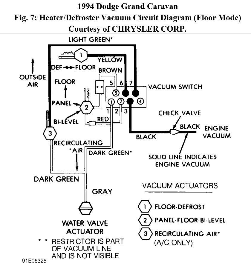

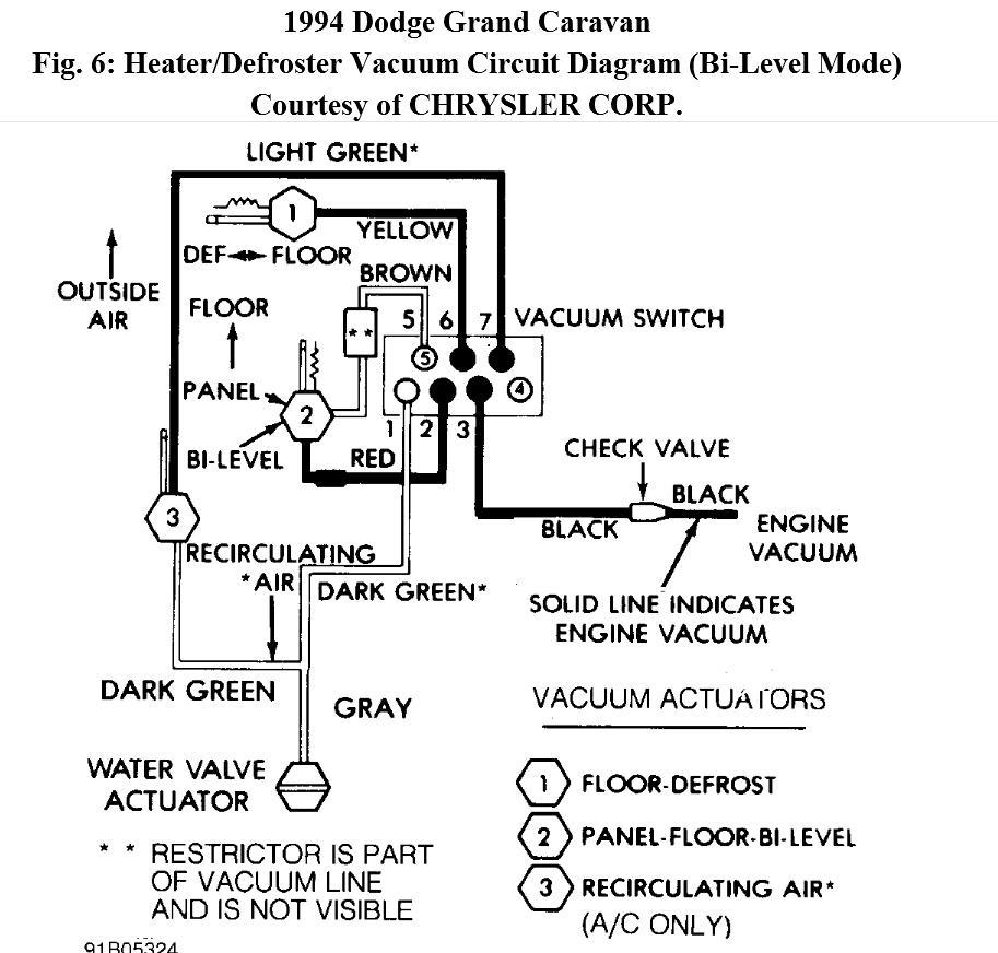

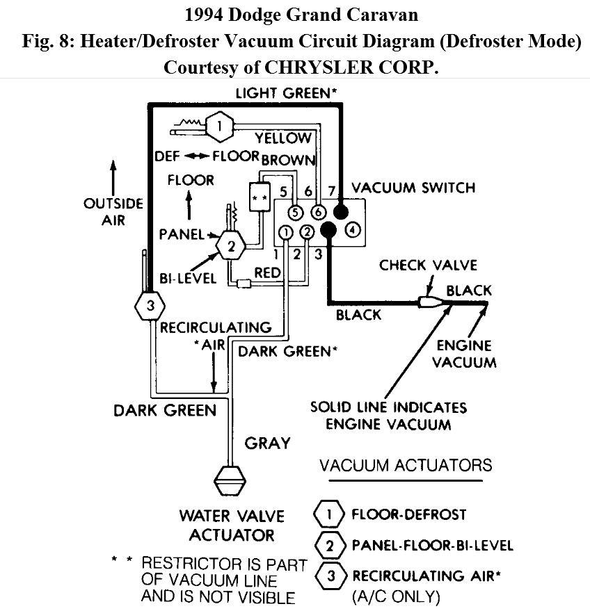

The various diagrams shows how vacuum flows in each mode. From the brake booster, there must be vacuum going to the HVAC system. If you do not have any vacuum from the brake booster, the vacuum line is either kinked or dislodged.
If any of the vacuum lines providing engine vacuum is leaking or dislodged, it would affect the others.

The brake booster works on vacuum and the HVAC system piggy backs on the system. You need to check the hose leading from booster to HVAC system. There is a checkvave in betyween, ensure it has not been reversedly installed, which would result in a no vacuum situation.
