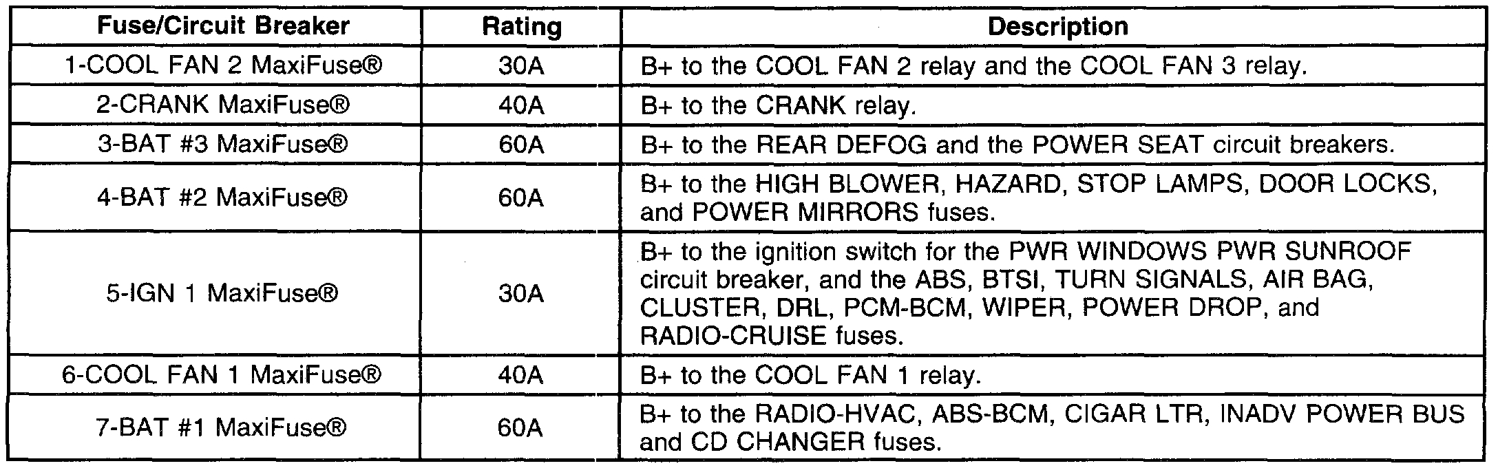

Now, if the electric fans are not turning on, the first thing I need you to check are the fuses in the under hood fuse box. There is a 30 amp fuse there that provides power to the fan relays. I attached the fuse box legend relevant to this fuse.

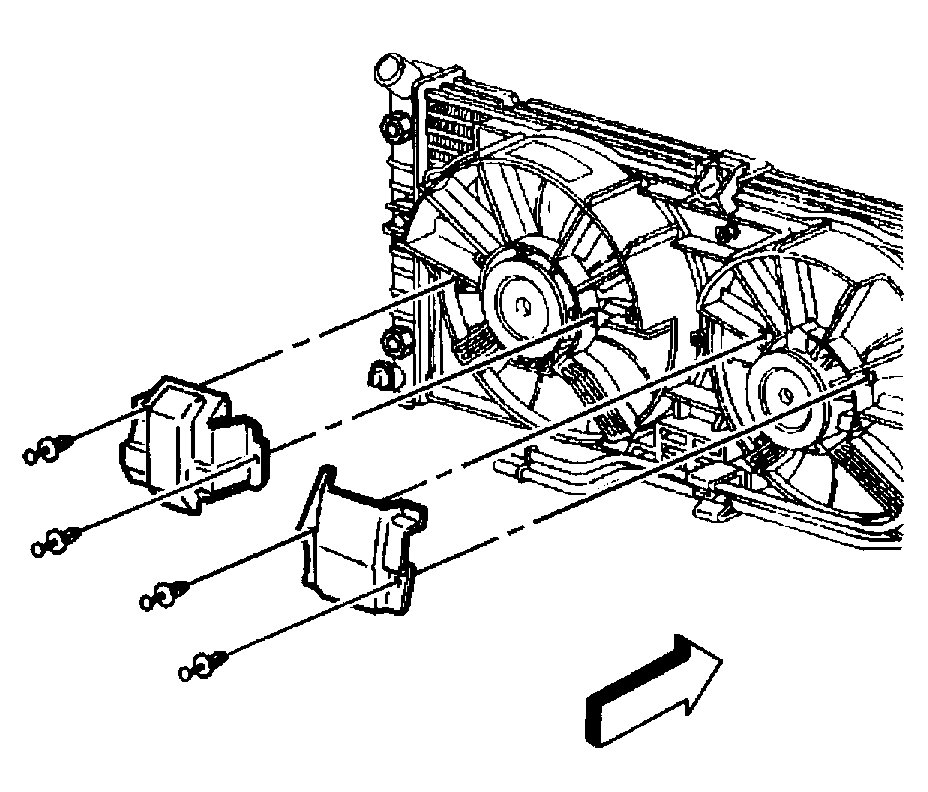

1. Remove the cooling fan assembly.
2. Remove the cooling fan heat shield(s).
3. Disconnect the cooling fan motor electrical connector(s).

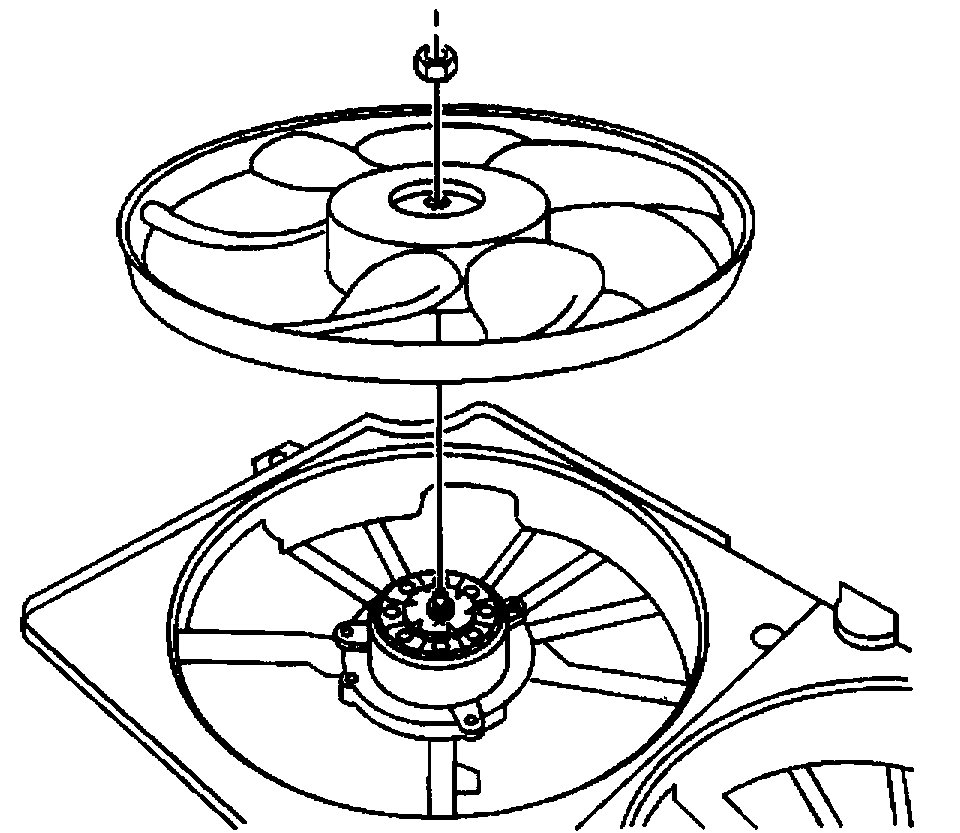

4. Remove the cooling fan blade nut.
5. Remove the cooling fan blade.

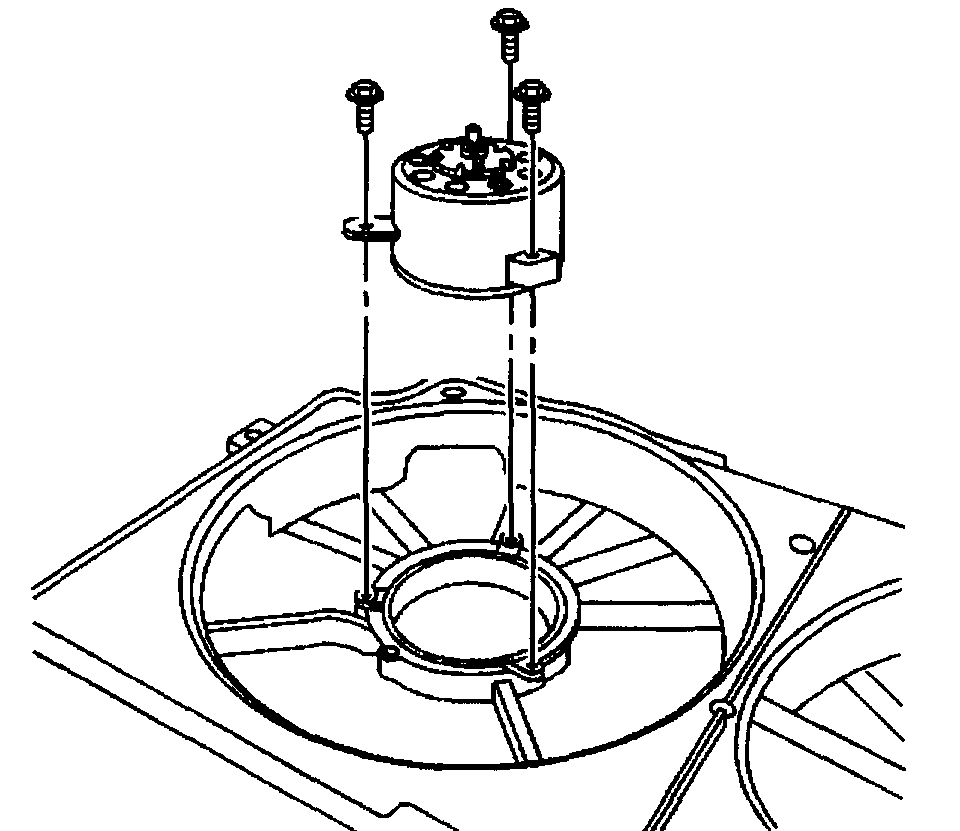

7. Remove the cooling fan motor bolts.
8. Remove the cooling fan motor.

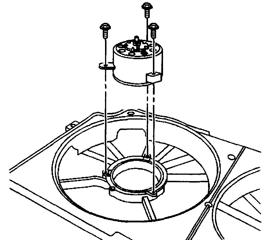

1. Install the cooling fan motor.
2. Install the cooling fan motor bolts.
