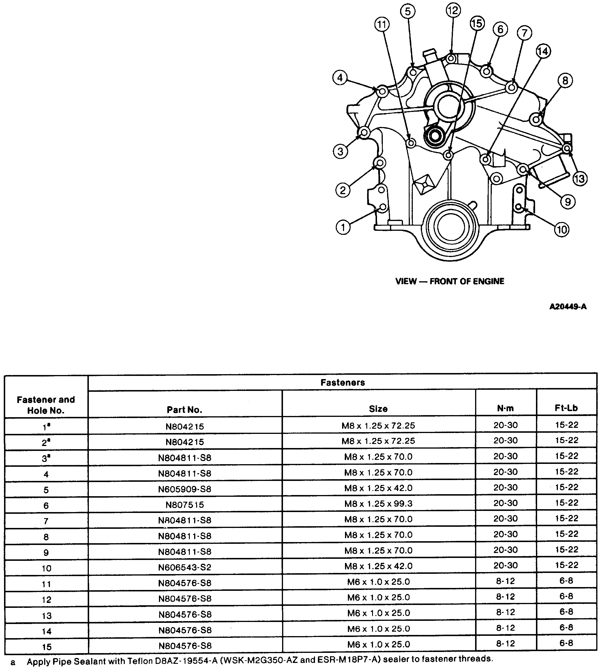

1. Clean gasket surfaces on engine front cover and water pump carefully.
CAUTION: Use care as aluminum gouges easily.
2. Position a new gasket on water pump sealing surface using Gasket and Trim Adhesive to hold gasket in position.
pic 1

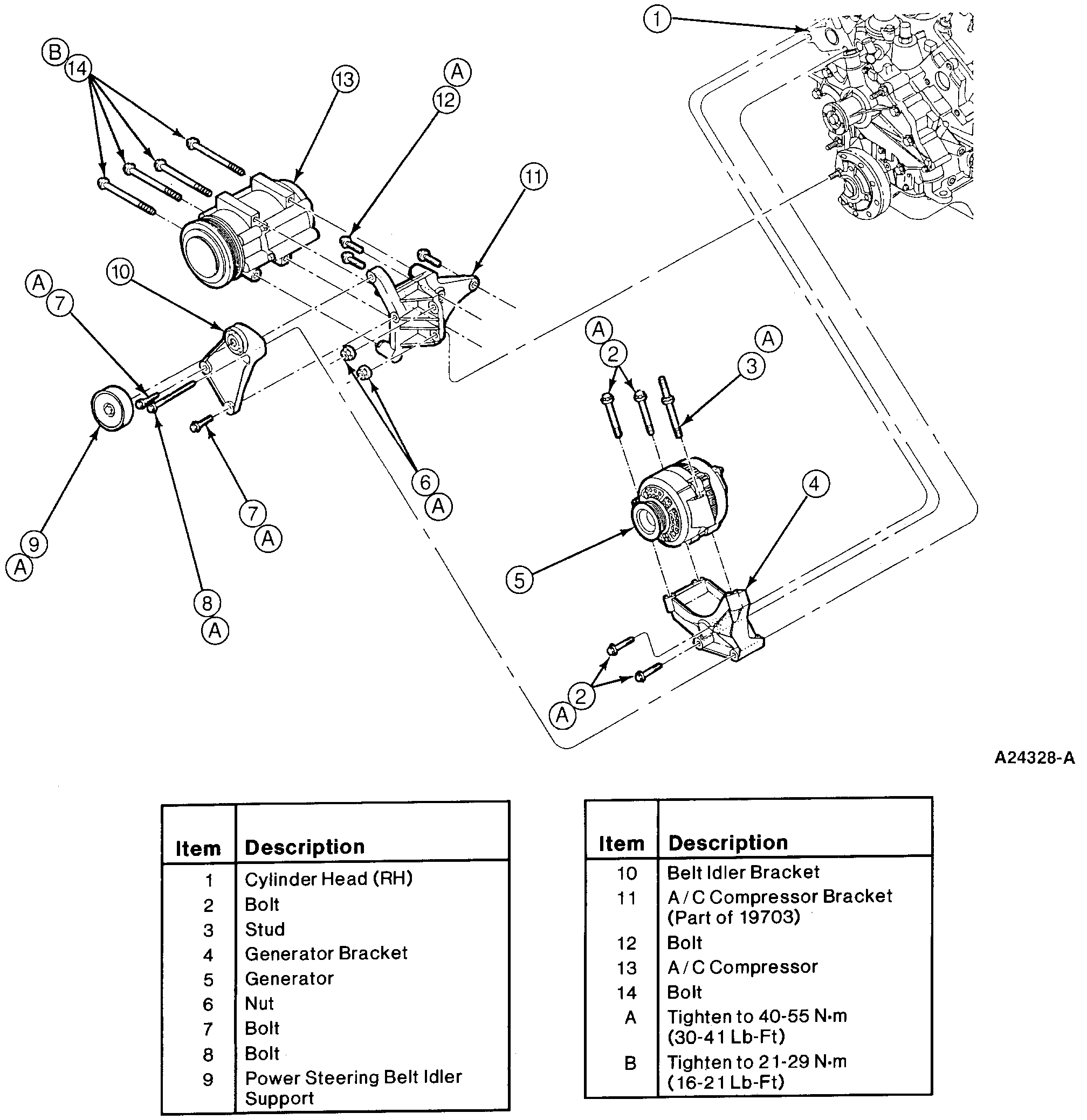

3. Install water pump on engine front cover and hand-tighten 12 attaching bolts. Tighten to specifications on accompanying chart.
4. Reinstall lower radiator hose at water pump and radiator and tighten clamps.
pic 2

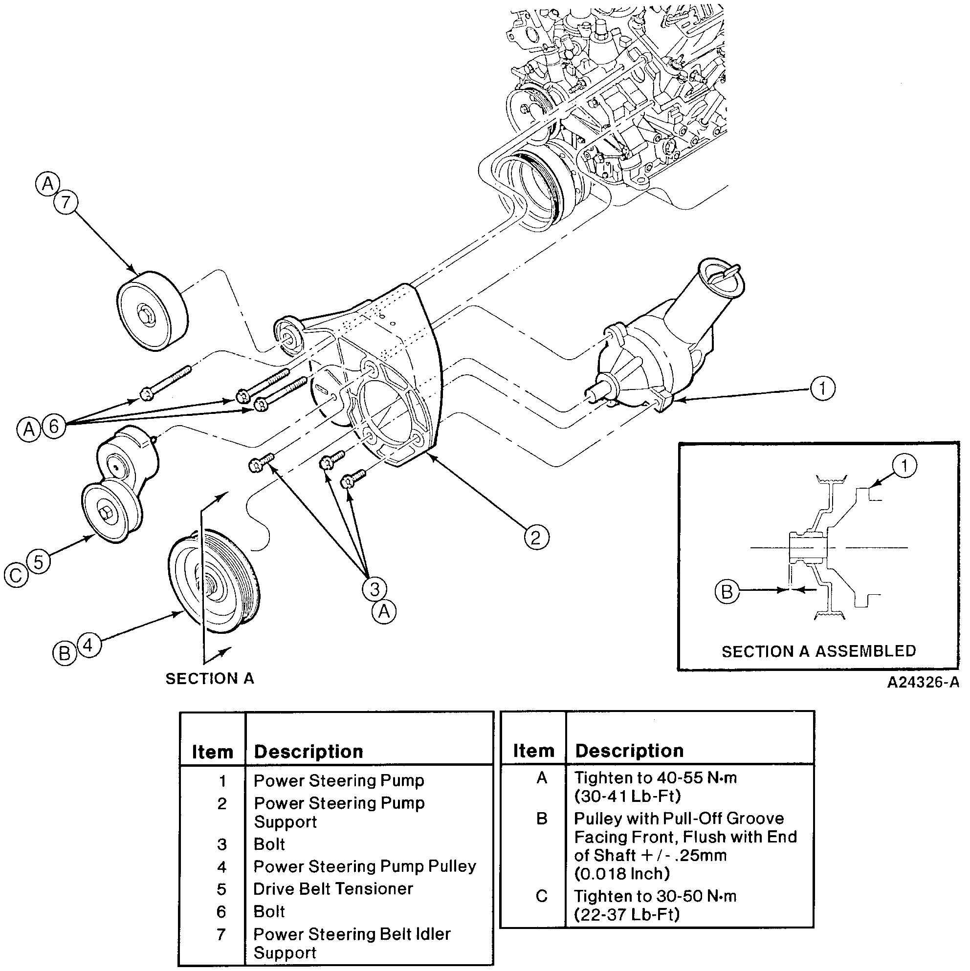

5. Reinstall power steering pump support bracket to engine and torque to 48-61 N.m (35-45 lb-ft).
6. Reinstall engine accessory drive belt tensioner and torque to 40-54 N.m (30-40 lb-ft).
7. Reinstall engine accessory drive belt tensioner and torque to 35-45 N.m (27-33 lb-ft).
8. Install heater water return hose at water pump fitting and tighten clamp.
9. If equipped with auxiliary heater, reinstall auxiliary heater tube bracket at power steering pump support bracket and torque to 8-12 N.m (6-8 lb-ft).
pic 3
10. Reinstall generator and bracket assembly to right cylinder head with 3 bolts and torque to 40-54 N.m (30-40 lb-ft).
11. Reconnect 3 wiring connectors in generator.
12. Install oil fill tube bracket over stud at generator and torque retaining nut to 42-50 N.m (32-37 lb-ft).

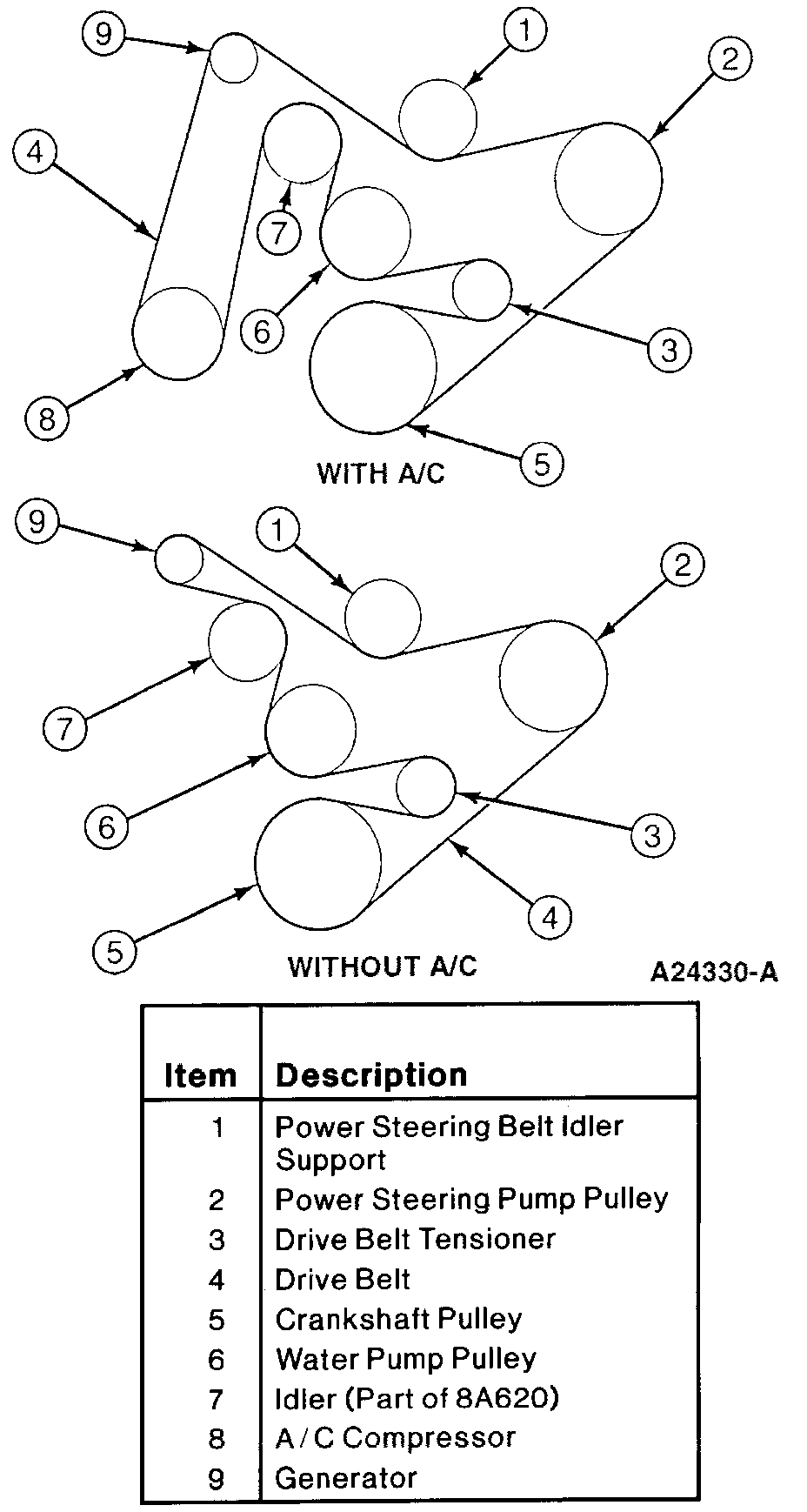

13. Install water pump pulley on water pump hub and tighten bolts finger-tight.
pic 4
14. Wrap engine accessory drive belt around all pulleys except generator. ROTATE belt tensioner CLOCKWISE and when belt clears, slip over alternator pulley.
15. Torque water pump pulley bolts to 23-32 N.m (18-24 lb-ft).
