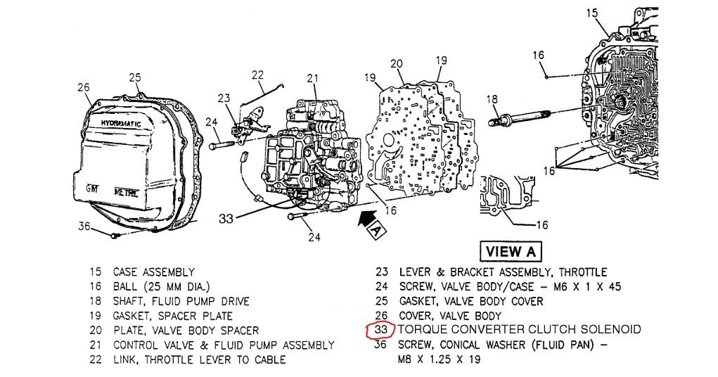

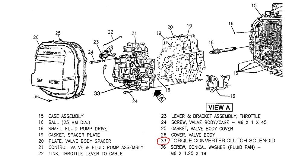

When I come to a stop at a red light, my car shuts off. It will start right up, but when I put it into reverse or drive, it falls shuts off again. It does this for about 20 or 30 minutes, and then it drives just fine.
