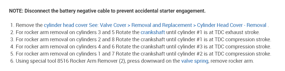

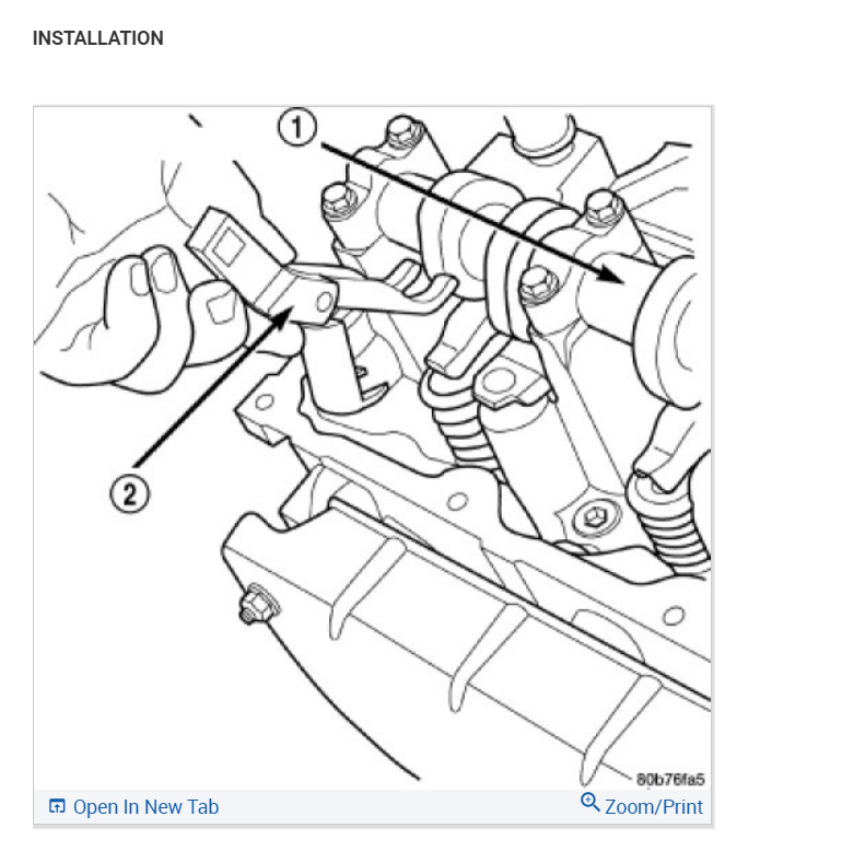

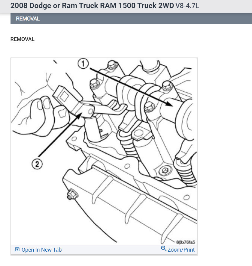

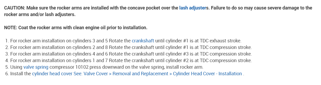

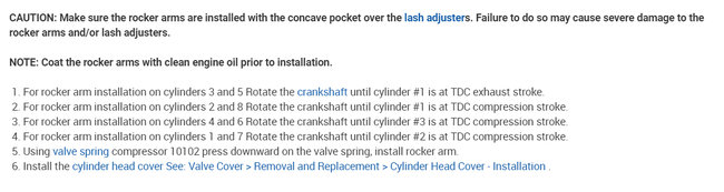

The rocker arm falls off because it is broken/worn, or the engine was over revved. I would get a new one and look at the camshaft to make sure the lobe is not damaged. Please send images if you are unsure of the damage. Here are instructions on how to replace the rocker arm in the diagrams below. Check out the diagrams (below). Let us know what happens and please upload pictures or videos of the problem.

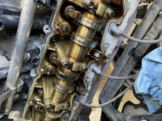

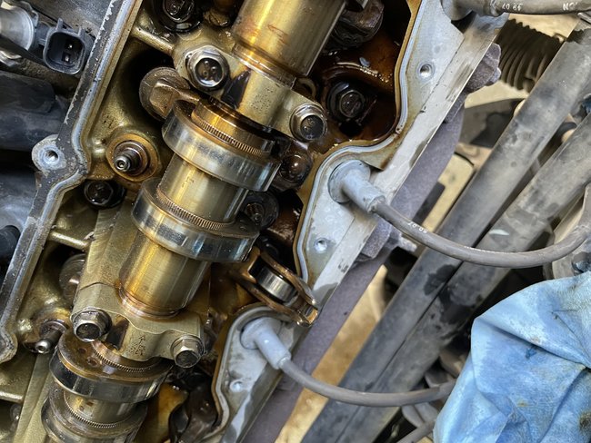

Here are some photos of the camshaft.
Jun 2, 2022 at 9:31 AM
Camshafts look good, replace the rocker and let see what happens.
