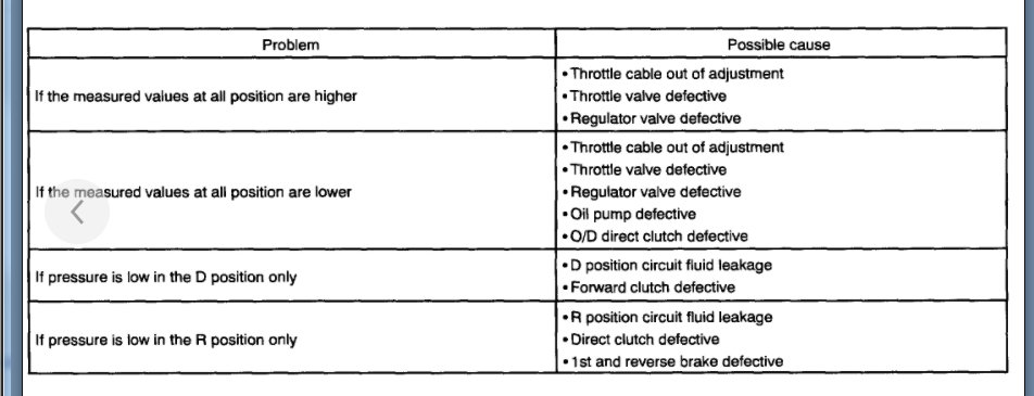

Just to be clear, the vehicle will move 500 meters after each of these repairs one time and then will not move any more? Or will it move 500 meters after sitting for a while?

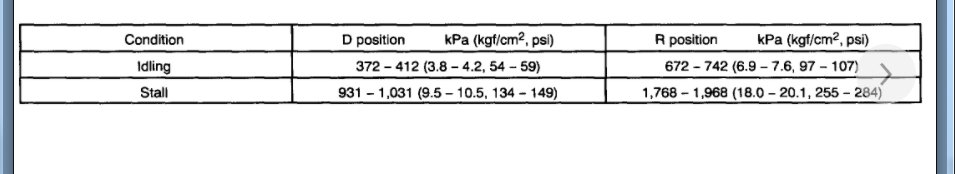

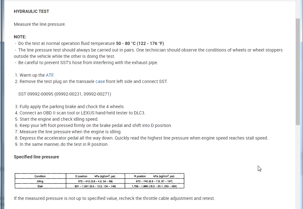

This sounds like a possible fluid issue or the pump is failing. Basically the way this works is the pump builds pressure in the unit in order to apply the clutches which moves the vehicle.
The other possible cause of this is a leak from a seal inside the unit.
We need to start with testing the pressure inside the unit and go from there. I attached the process below from the manual.
