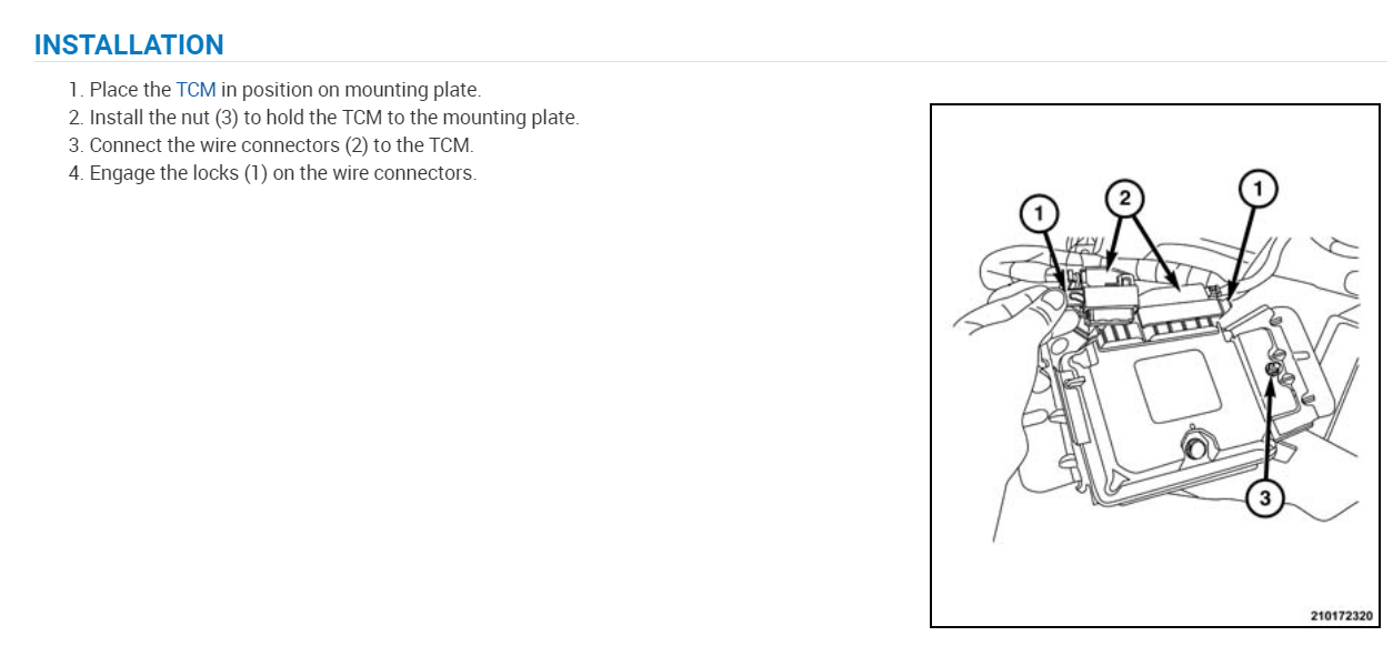

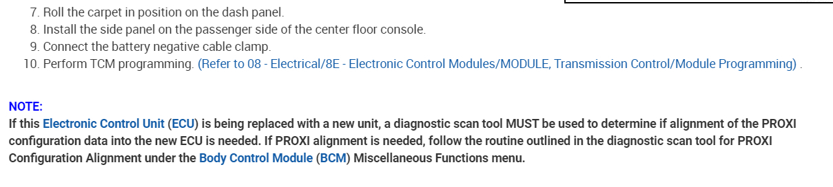

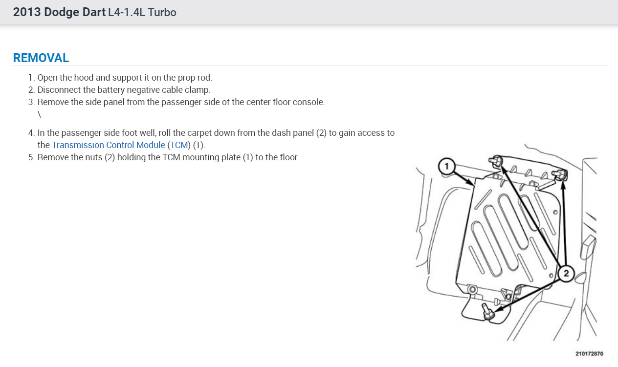

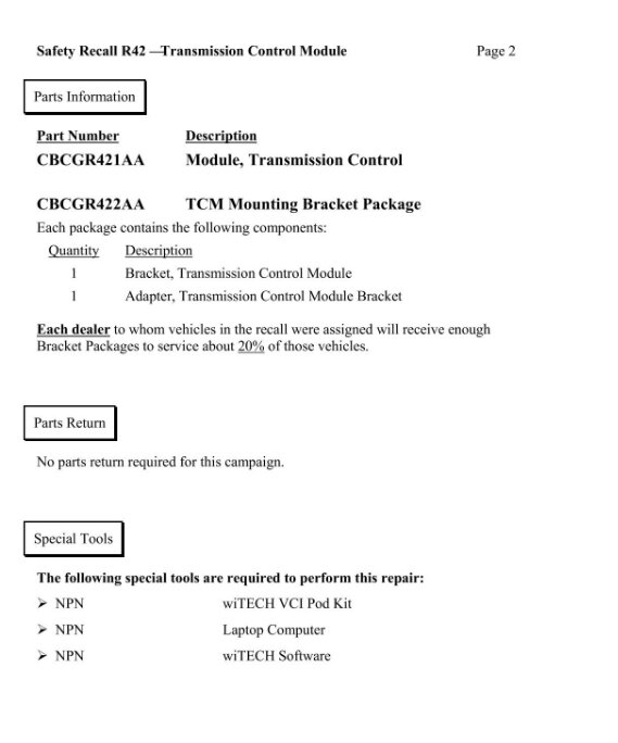

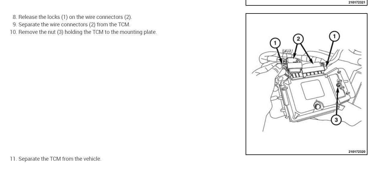

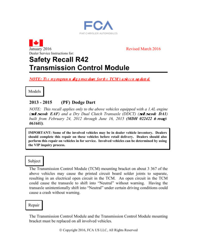

Can I ask if the transmission slips in either odd or even gears only? Also, we should run the codes to see what comes up. This guide can help. You can get a CAN scanner (Controller Area Network) from Amazon.
Here is a video to show you how:
https://youtu.be/u-4syLc-ifQ
and
https://www.2carpros.com/articles/can-scan-controller-area-network-easy

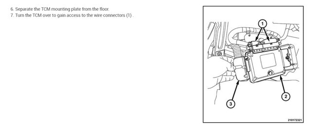

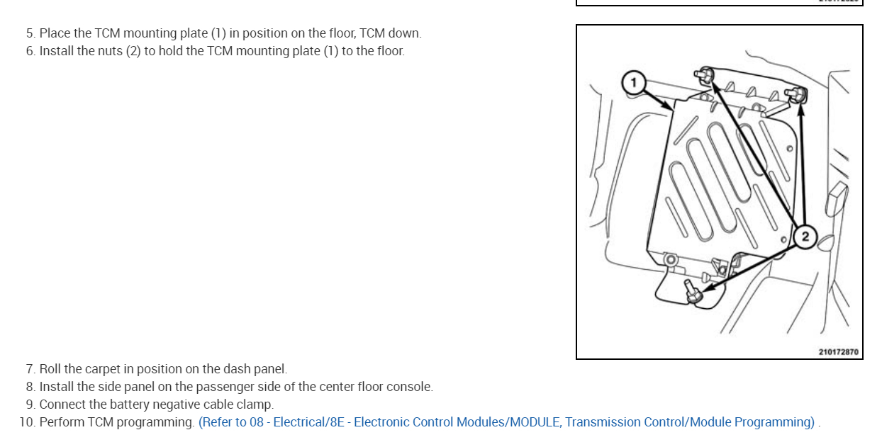

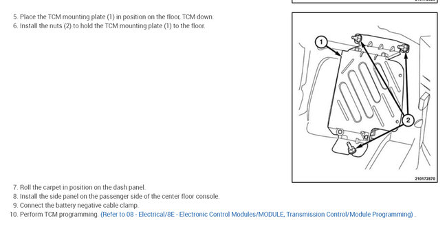

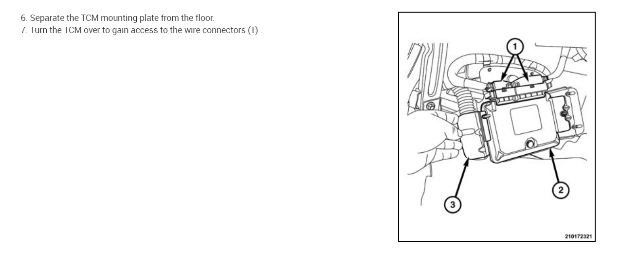

You may have a controller going out because there is a TSB for this problem which I have included as well and how to fix it. Check out the images (below). Please let us know what you find. We are interested to see what it is.

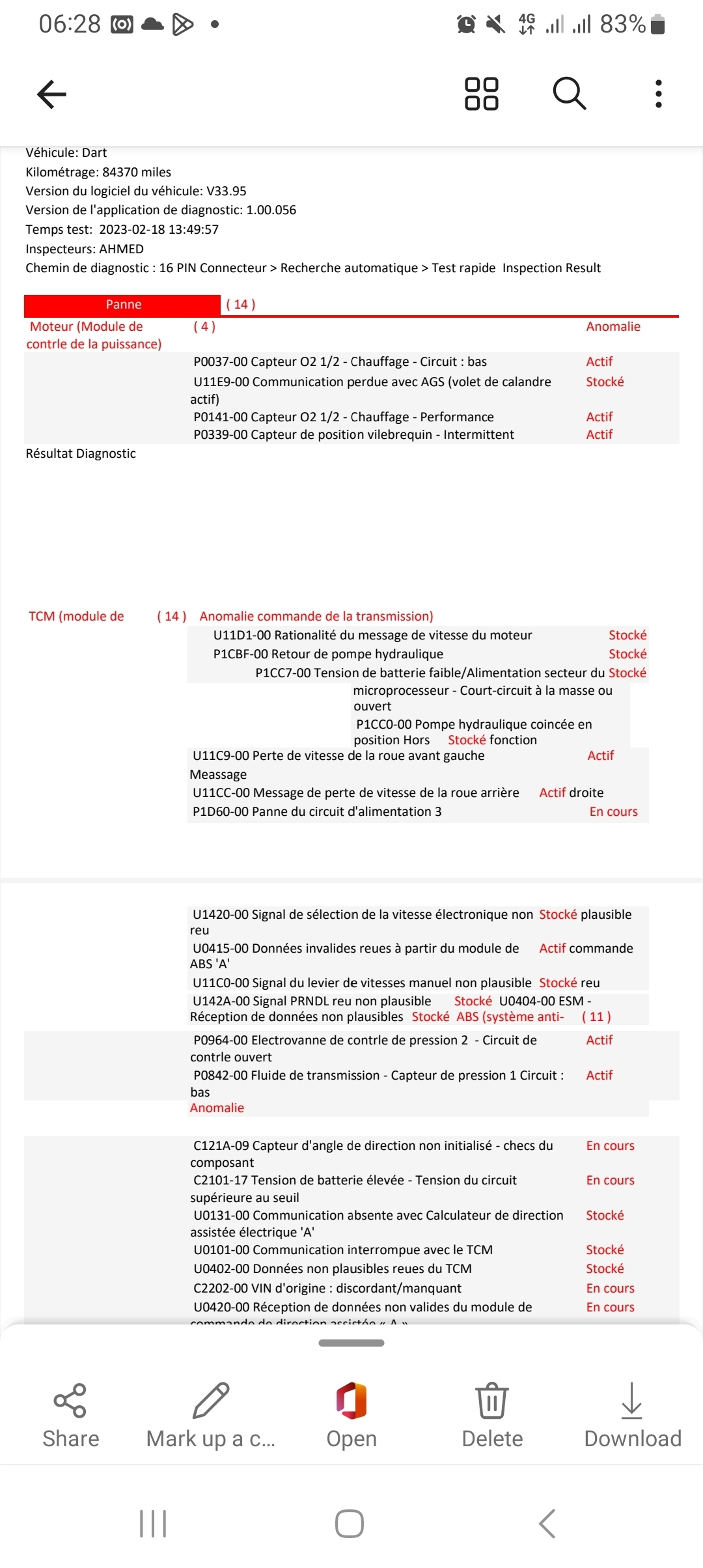

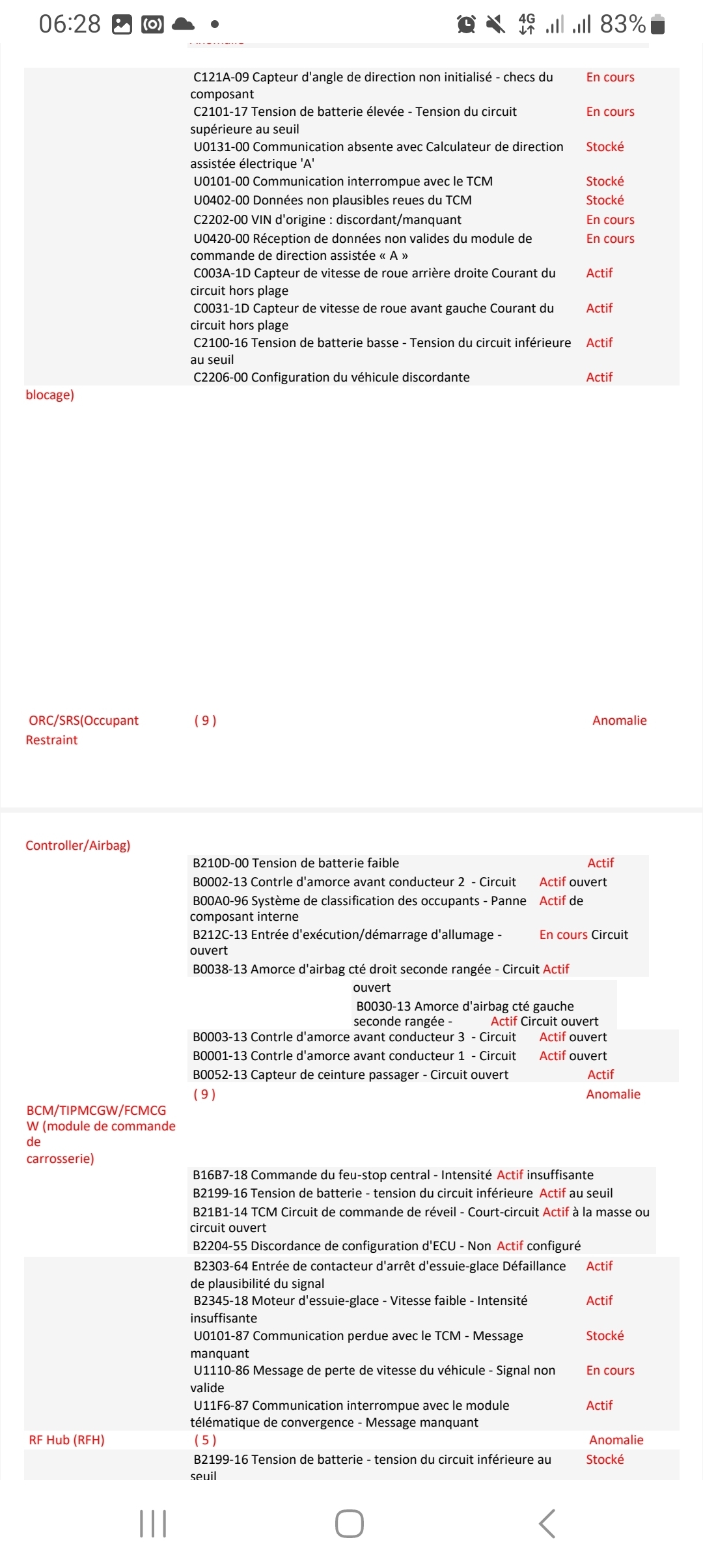

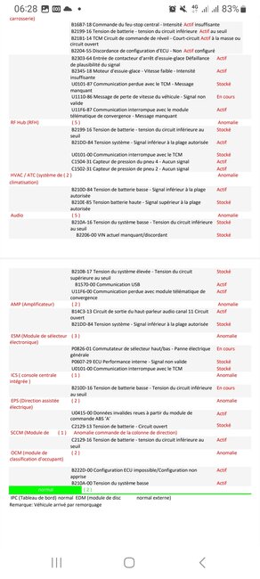

ALIDODGEDART
Here is the scan.
Mar 2, 2023 at 10:32 PM
Yep, it looks like the TCM is out. You can get a rebuilt unit by searching google or eBay. Let me know what happens.
