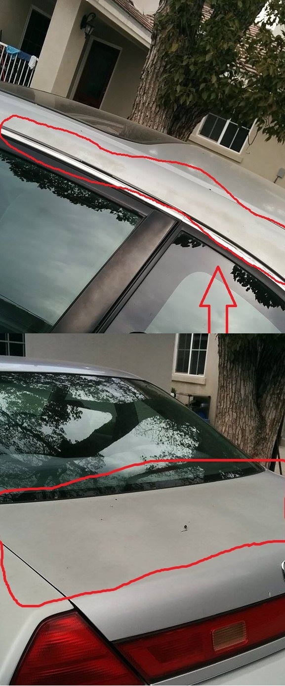

THIS IS THE "CLEAR COAT" PEELING OFF
THESE NEWER RIGS ('80s ON UP) HAVE A "BASE COAT" (USUALLY SORTA DULL WHEN APPLIED) AND THEN IT'S "CLEAR COATED" (WHICH MADE IT SHINEY)
SOMEBODY WITH NOTHING TO DO CAME UP WITH THIS SYSTEM!
WELL, YOU SEE WHAT IT DOES OVER TIME AND IN THE SUN
IF IT HAD GOT A DEEP SCRATCH IN IT WHEN IT WAS YOUNGER, IT MIGHTA TORE THRU THE CLEAR COAT AND DOWN INTO THE BASE COAT, BUFFING WOULD NOT AND COULD NOT HAVE FIXED IT
ONE STAGE KINDA PAINT, (ACRYLIC ENAMEL) LIKE USED ON BOTH OF MY JEEPS IS JUST MIXED WITH A HARDENING AGENT, THINNED DOWN WITH REDUCER, THEN SPRAYED ON WITH A GUN AND LET DRY (SORTA LIKE USING A SPRAY CAN) WHEN IT DRIES, IT'S SHINEY.
SCRATCHES THAT DON'T GO ALL THE WAY TO THE METAL CAN BE COMPOUNDED/ BUFFED OUT, AS THE COLOR IS THE SAME ALL THE WAY THRU THE COAT(S) APPLIED

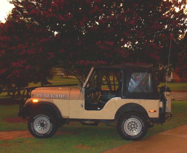

ON MY JEEP, I WAS DOING WHAT I COULD AFTER WORK, WITHOUT MAKING A BIG MESS, AND IN THE GARAGE. BELOW, YOU WILL SEE THE LIGHTER COLOR ON MY CJ-5, EVERY BIT OF THAT WAS AIRBRUSHED ON, THE COLD CAUGHT UP WITH ME, I STILL HAVE TO DO THE DARKER COLOR WHEN IT WARMS UP AGAIN!
