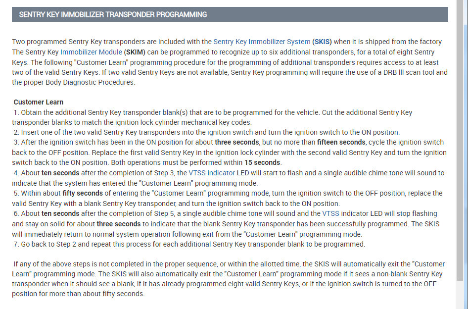

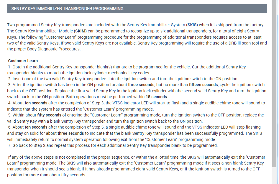

This could just be a key issue but you need 2 valid operating keys to program additional keys. If you only have one key or less then you will need to use a scan tool to program a new key.
I attached the process below for your review.
