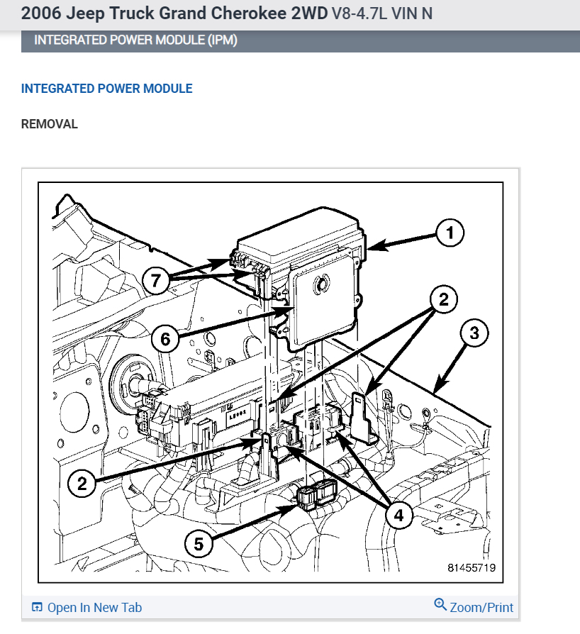

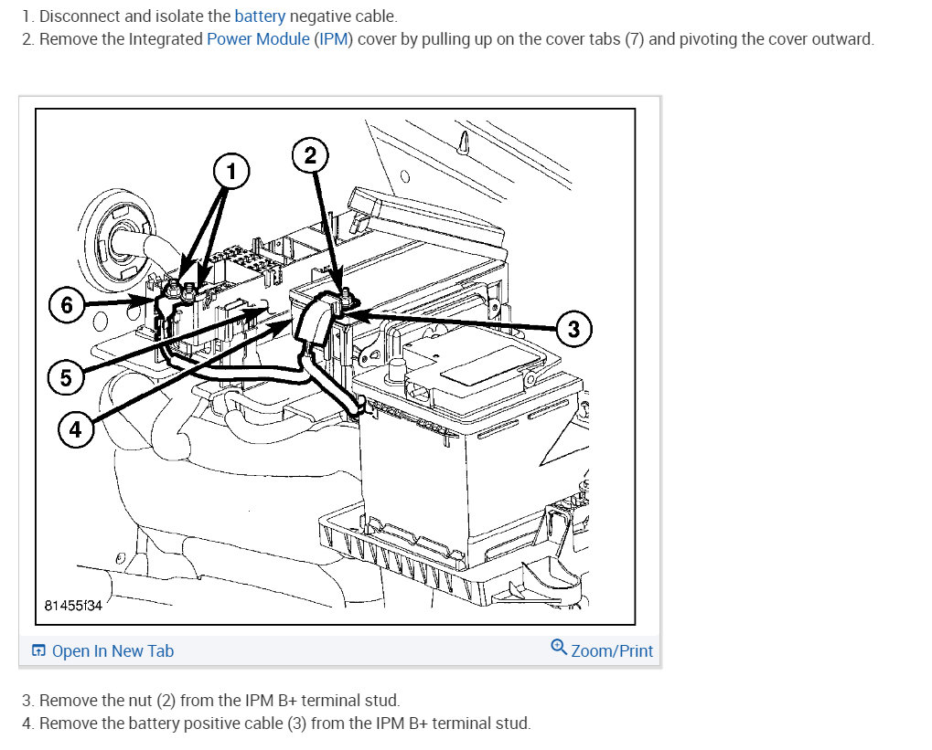

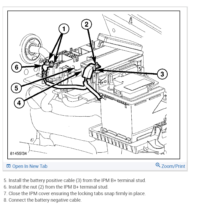

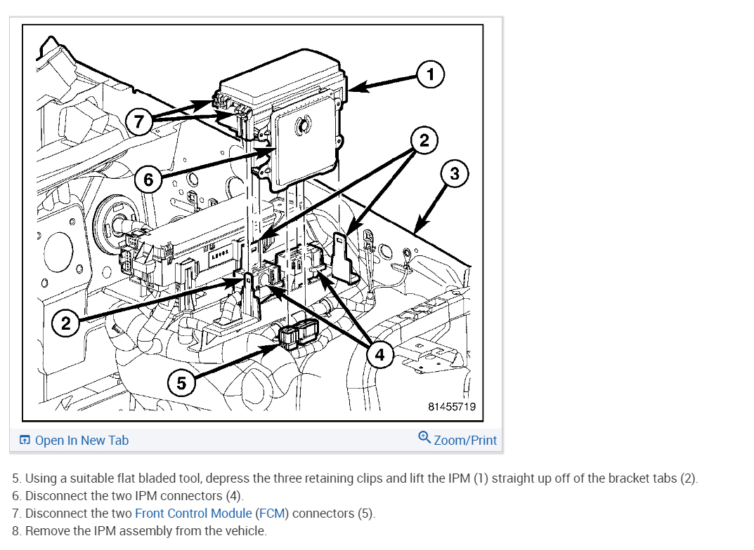

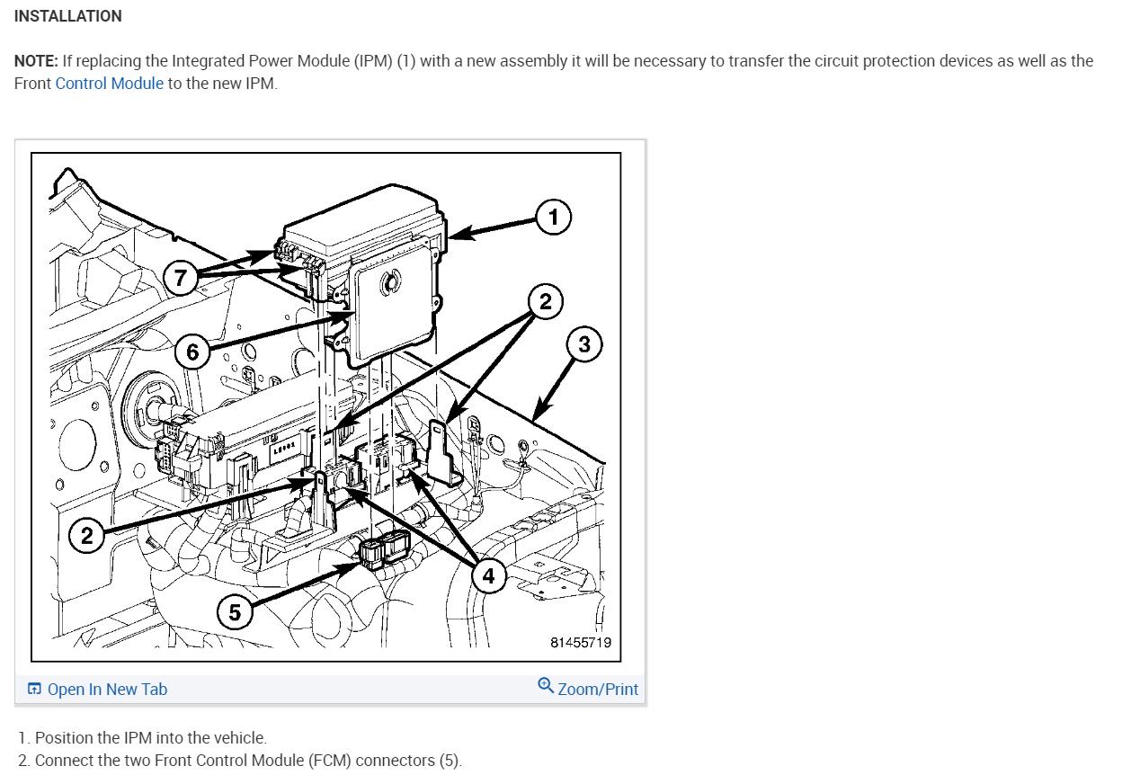

There is an integrated power module that has gone bad which needs to be replaced which is easy to do because it itself-initializes, here is the location and how to replace it in the images below. Check out the diagrams (below). Please let us know what happens.
