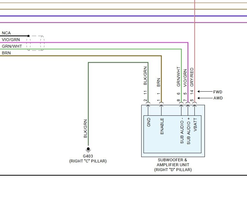

I’m trying to locate the factory amplifier. I looked on the passenger back where the subwoofer is, I found a little amplifier, but it doesn’t look like it is big enough for the entire audio system. I don’t know if that just for the subwoofer or not I can’t find a straight answer anywhere that the only amp I have found.

That is the amplifier for the subwoofer. It is the only amplifier that truck has. The rest of the speakers get their power from the audio unit itself.
