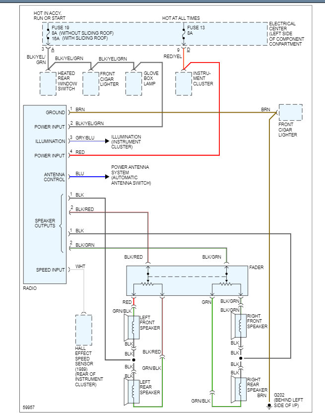

I’ve been trying to install an aftermarket stereo and I’m having trouble with the alarm, there’s two brown wires and one blue wire, I’m not sure where they go into the new harness, all the factory harnesses are cut.

Here are the radio wiring diagrams so you can hook up the aftermarket radio and a guide to help test the connections:
Check out the images (below). Please let us know if you need anything else to get the problem fixed.
