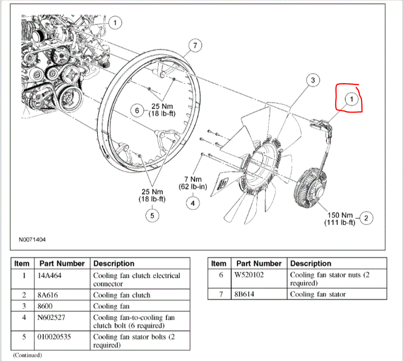

Based on that definition (sorry for the headache) I first have to ask if the check engine light has turned on? Next, I attached a pic below. Make sure the connection is tight, clean, and not damaged in any way.
