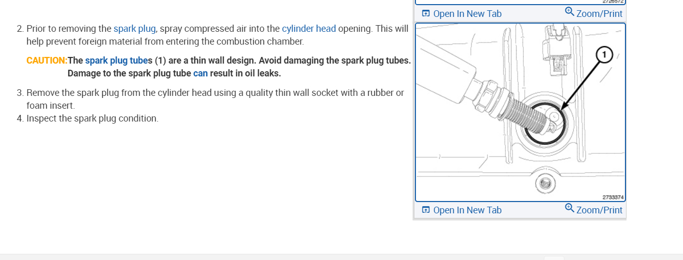

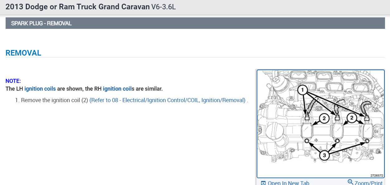

The P0302 code is the clue, it is telling you the #2 cylinder is having a problem. I would start with a full tune up including the spark plugs and servicing the throttle body.
Here is a guide and instructions below on how to do the job or see what needs to be done:
3.6L V-6 Spark plug - RER8ZWYCB4, gap 1.1 mm (.043 in.)
https://www.2carpros.com/articles/how-to-tune-up-a-car-engine
and
https://youtu.be/CE7bM8_j4Zg
and
https://youtu.be/Ui8zhMLp5EM
Use all OEM parts please. Check out the diagrams (below). Please let us know what happens.
