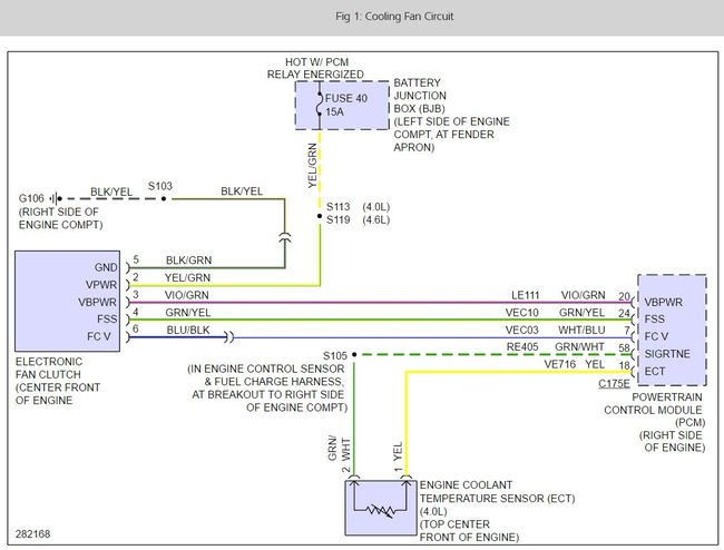

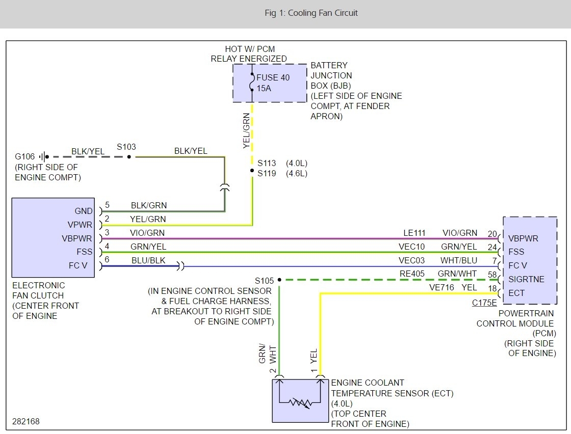

This is one of two things which are the problem, first it could be a defective electric fan or the PCM is intermittently sticking. Please use this wiring diagram to test the circuit, there is a chance the coolant sensor is going out as well.
Here is a some guide to help you get the problem fixed:
https://www.2carpros.com/articles/coolant-temperature-sensor-cts-replacement
and
Please run some tests and get back to us so we can continue helping you.
