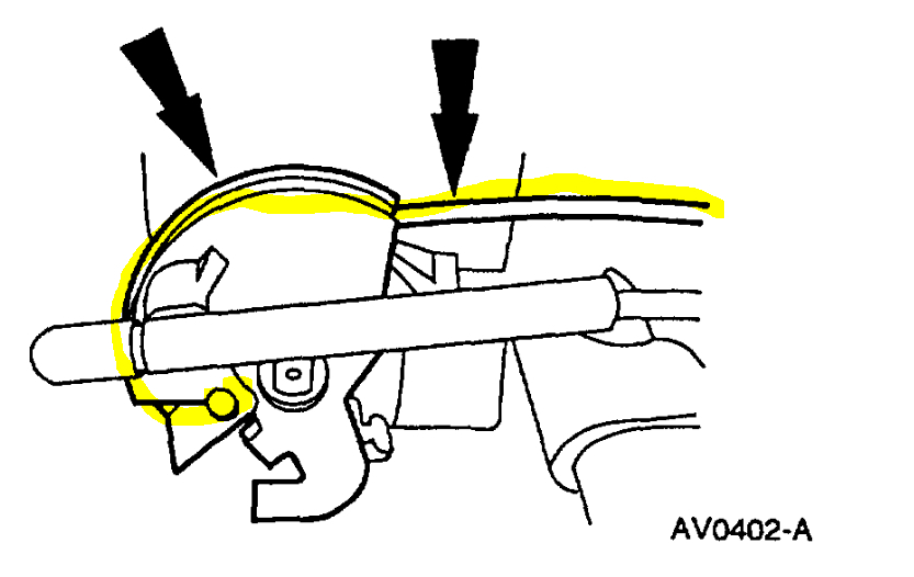

It does sound dangerous. Have you inspected the throttle cable for kinks, fraying, or anything that would prevent it from releasing?
The throttle cable runs from the throttle pedal to the throttle body under the hood. I attached a pic below. See if that cable is allowing the throttle to full release. Have a helper (with the engine off) press and release the throttle pedal while you watch for operation.

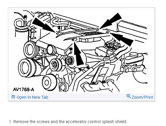

You will need to remove the plastic shield on top of the engine. Then, you will have access.
See pics 1 and 2 below and let me know what you find.
See pics below.
