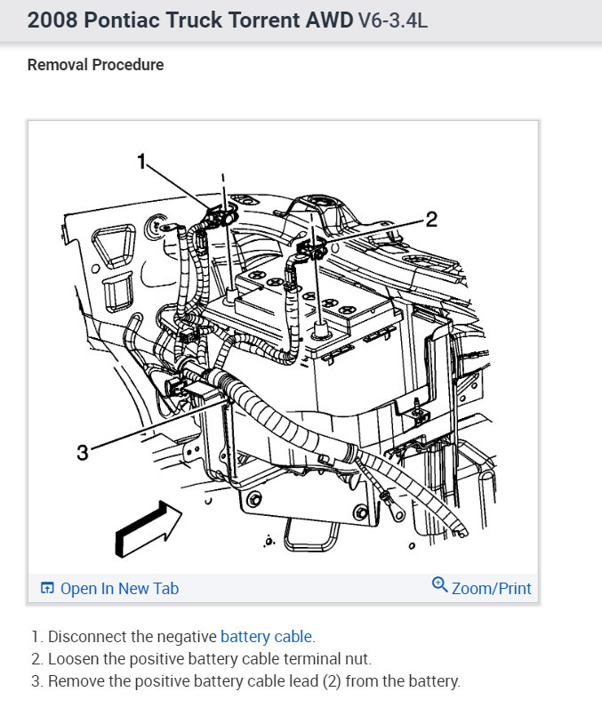

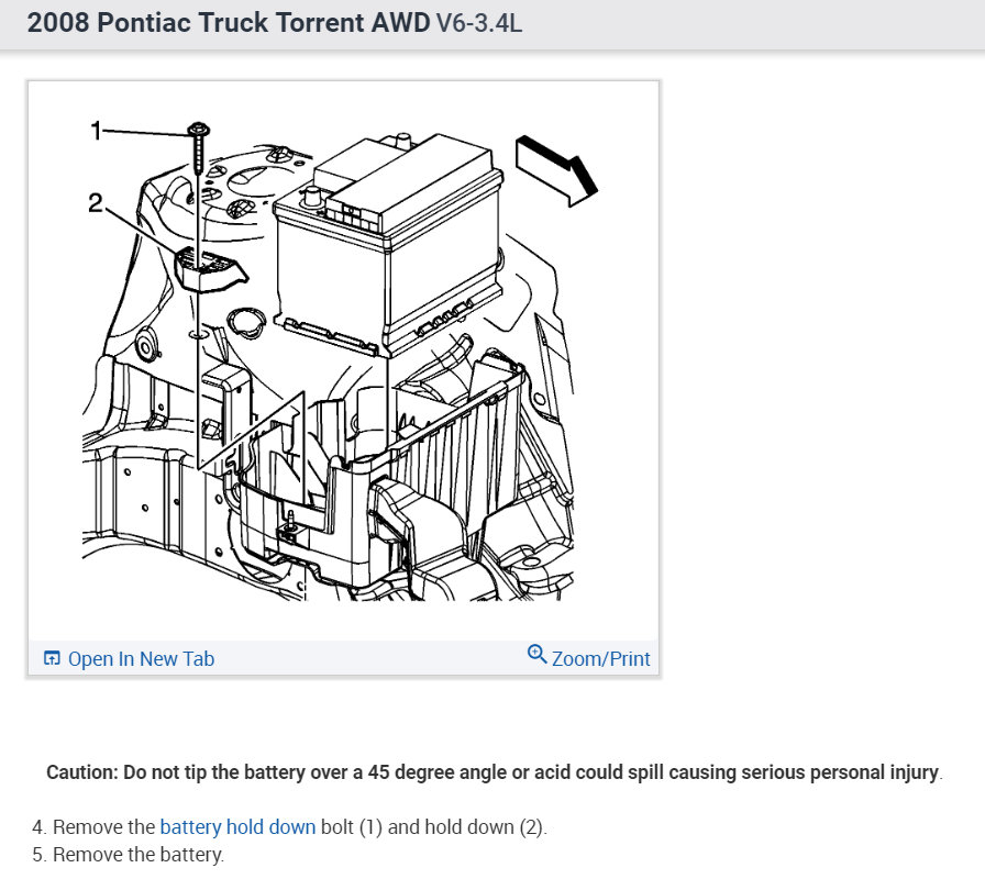

It sounds like the battery is weak. but to be sure here is a guide to confirm the issue with diagrams below:
and if it fails:
https://www.2carpros.com/articles/how-to-replace-a-car-battery
