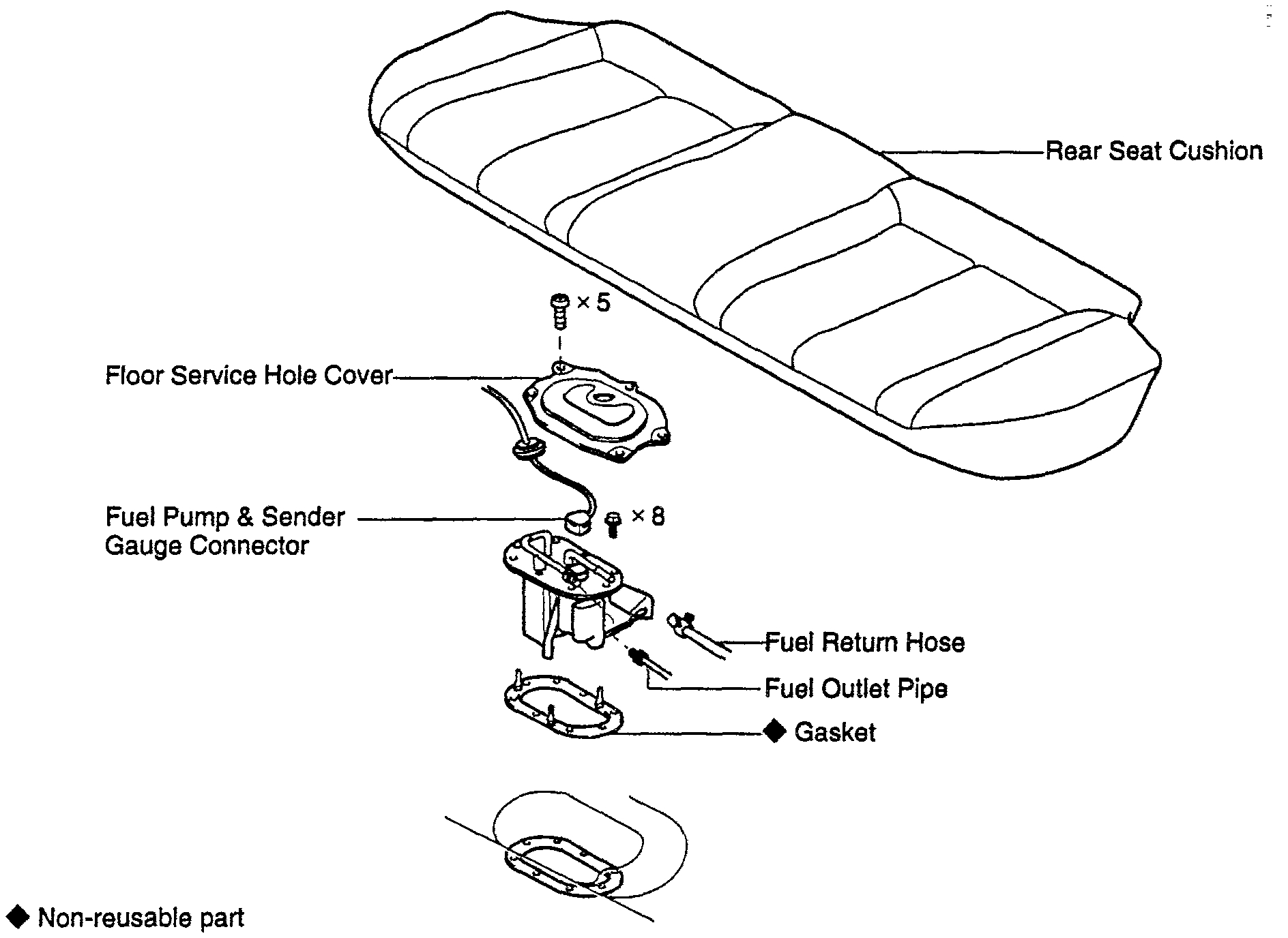

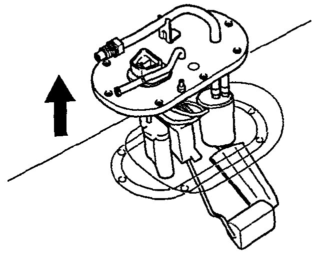

Remove the rear seat. Locate the access port to the fuel pump. Remove the port cover and inspect hoses from the pump assembly. Also, confirm there are no leaks where the top of the sending unit attaches to the tank.
See attached pictures.
Let me know what you find.
