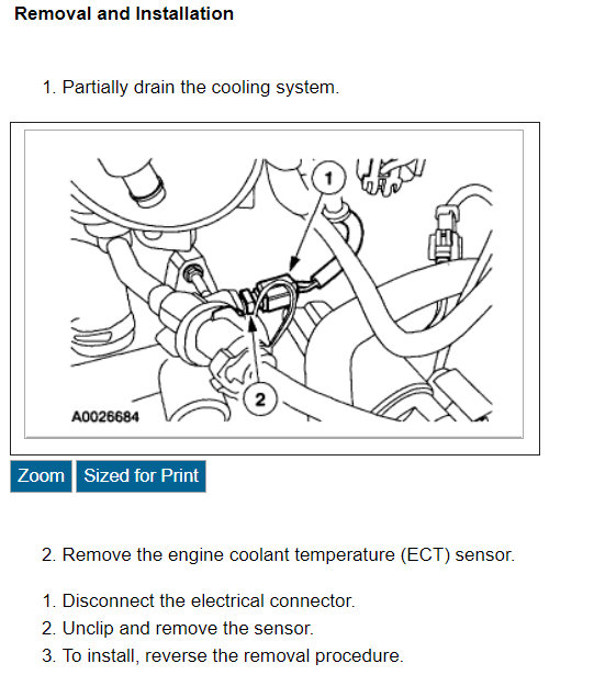

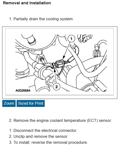

I have seen the engine coolant temperature sensor cause this problem on these cars. When this sensor starts to go out it will not trigger a check engine light. Here is a guide to help you see what you are in for when doing the job with the diagrams of the location for your car (below):
https://www.2carpros.com/articles/coolant-temperature-sensor-cts-replacement
This guide can help as well:
https://www.2carpros.com/articles/engine-cranks-excessively-before-starting
