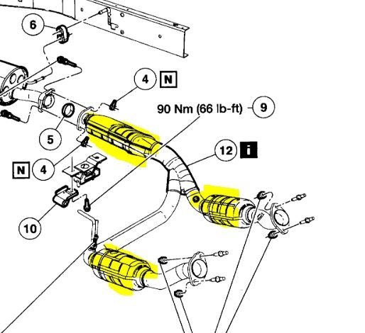

If you look at the picture I attached, you will see three things I highlighted. Those are the converters. They are part of what is called a Y pipe and both bolt to the exhaust manifold. Let me know if you have questions or just need help.
