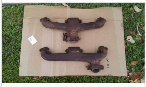

We just purchased the vehicle listed above (plow truck). Found out the exhaust manifolds were kinda patched together with JB Weld so been on the search and found these. These are off of a 1968 Dodge Coronet with a 318. Just looking to me they look like they'll work,but that is why you guys are the pros..

The bolt pattern does look similar. Have you had a chance to mock them up and see if they bolt directly to the cylinder heads with no issues? You might have to do a little tweaking to get the actual exhaust pipes to mount to the manifolds. Hope this helps and thanks for using 2CarPros.

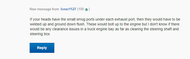

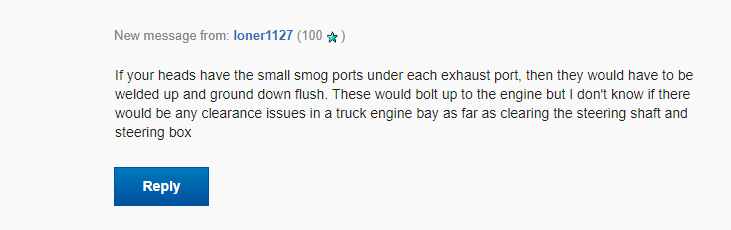

This is the last message from the seller, but i have no idea what he's talking about. maybe you can put it in layman's terms..lol.

Yeah, we got several within 100 miles from us, looked at few, but, at this guys price, i'm getting the set cheaper than just one from some.
Nov 12, 2019 at 8:10 AM
DANNY L
  • 5,648 POSTS
Hello again,

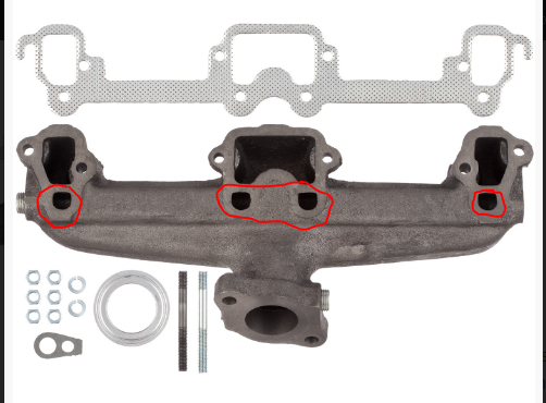

I found this picture.I believe these are the smog ports the seller was referring to. Picture attached below and smog ports are circled in red. I'll continue to collect more info on this.Hope this helps and thanks again for using 2CarPros.

Sorry, forgot to attach. Here it is. Smog ports circled in red.

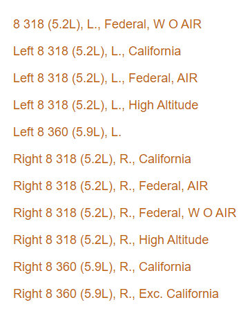

Take a look at this picture below and let me know what your truck is equipped with and I'll get you the Hollander number.

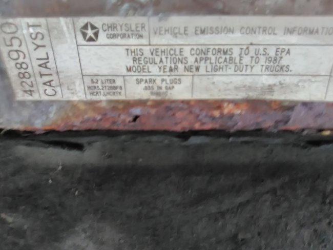

Haha, I couldn't begin to tell you, all i know is the engine is a 318. is there a digit in the vin? to help me differentiate, with which one on your list here? Sorry, not that knowledgeable in this matter.
Nov 15, 2019 at 3:47 AM
DANNY L
  • 5,648 POSTS
Hello again.
Okay, take a look at the equipment sticker located under the hood. It's usually affixed to the radiator support or on the underside of the hood. It will say "This vehicle conforms to CA or Federal emissions standards" If your truck has a smog pump it will be mounted to the engine and is belt driven.Lines from this smog pump will tap into the exhaust manifolds.If you can take a video of all the stickers under hood and the front of the engine and upload here and I can decipher.Hope this helps and thanks again for using 2CarPros.

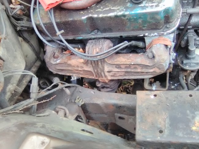

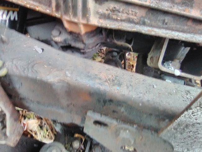

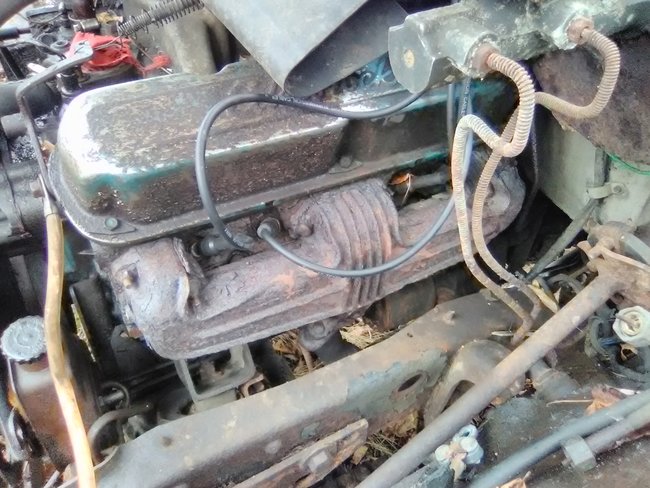

Hey Danny. Well i have been so engrossed with working on the passenger side,( mainly because that's where the major leak was at, and the plow hydraulics) that i didn't pay close enough attention to details. these pics show and tell, I'm such an idiot.
Nov 17, 2019 at 11:37 AM
DANNY L
  • 5,648 POSTS
As Homer would say (DOH!)
I've attached pictures below of the Hollander part numbers. These are numbers used that are universal to any salvage yard or parts stores.Your truck is Federal emissions without air.Hope this helps and keep me updated.Thanks again for using 2CarPros.
