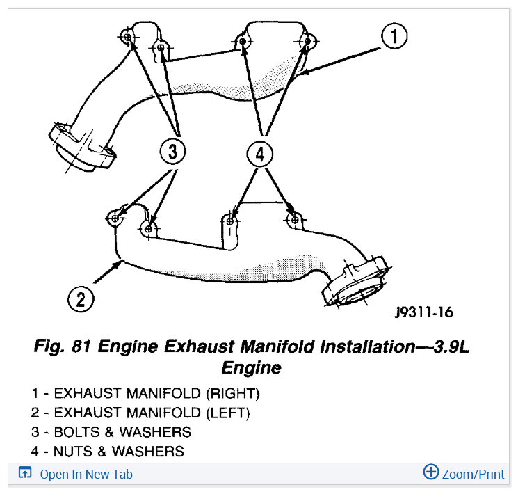

Also do I have a few bolts that have nuts holding the exhaust cover on studs? And what technique besides using heat. would warming engine help? I don't have a torch but a heat gun. Hopefully a few use nuts, not bolts too.

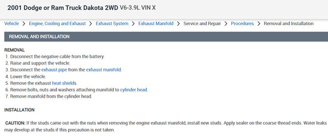

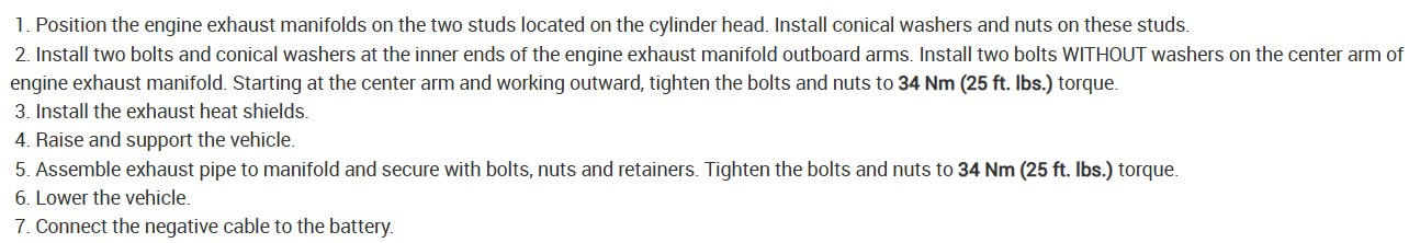

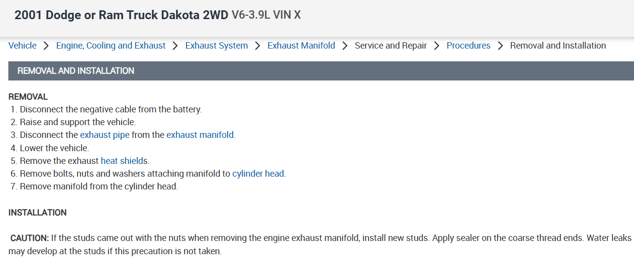

If you upload a short video of the noise, I can tell for sure what's going on. Here is a video that will help you if you break one of the exhaust manifold bolts and I included instructions on how to remove the exhaust manifolds as well.
https://www.youtube.com/watch?v=py-rIWATchY
Please start a new thread for the oil leak problem. Sorry, we only handle one problem per thread, please post your new question here, you must be logged in.
Check out the images (below). Please upload pictures or videos in your response of any problems so we can see what to help you with.

What technique helps to loosen bolts? I sprayed it a few days ago when warm. Will try again in morning. Is it too risky to use an air tool to loosen? Because of the high chance of break. can I leave studs in on 2 of the 4 and just remove nut?
