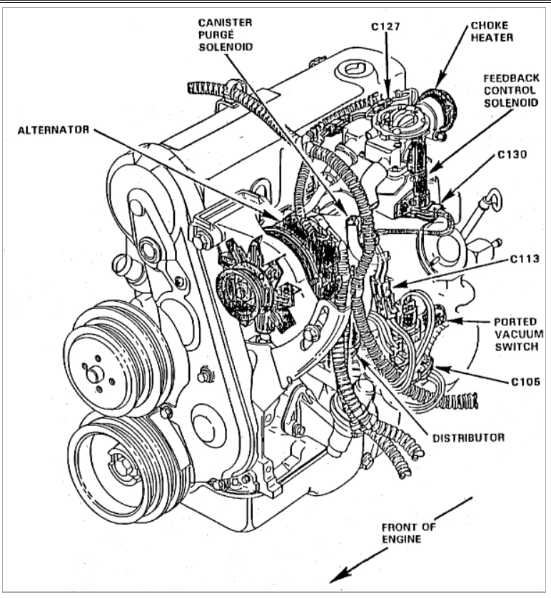

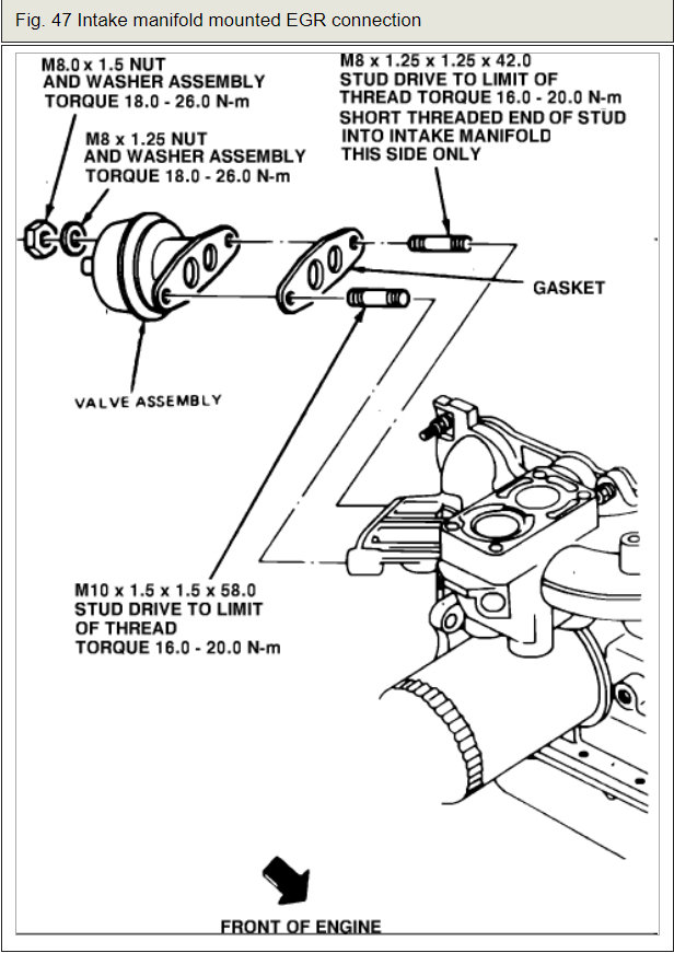

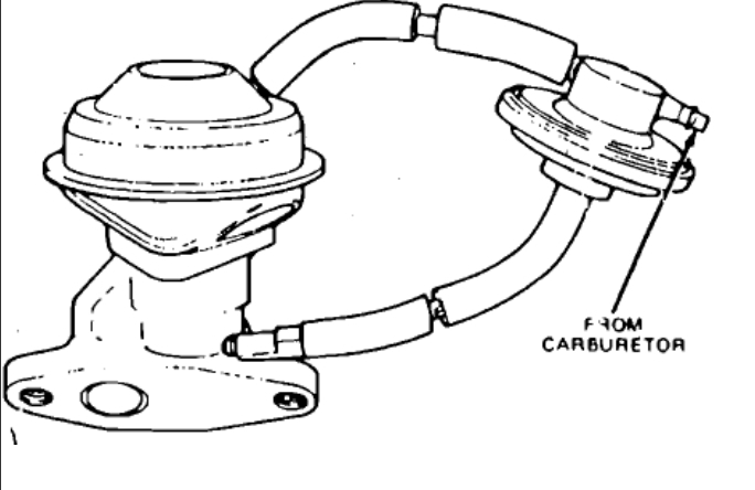

There is an EGR tube and fitting which I think is what you are wanting to know. Here are some diagrams to help you see what you are looking for.
Check out the diagrams (below).
