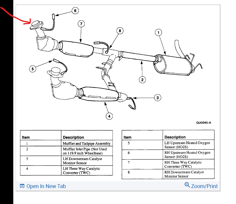

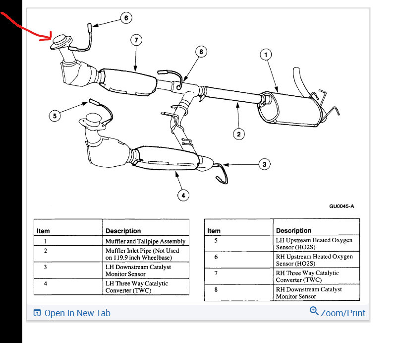

I have a two bolt pattern on my exhaust. But unfortunately I don't know the size or is it's doughnut gasket or not. If someone could please help me ... Thank you for your time.
Feb 10, 2023 at 2:57 PM

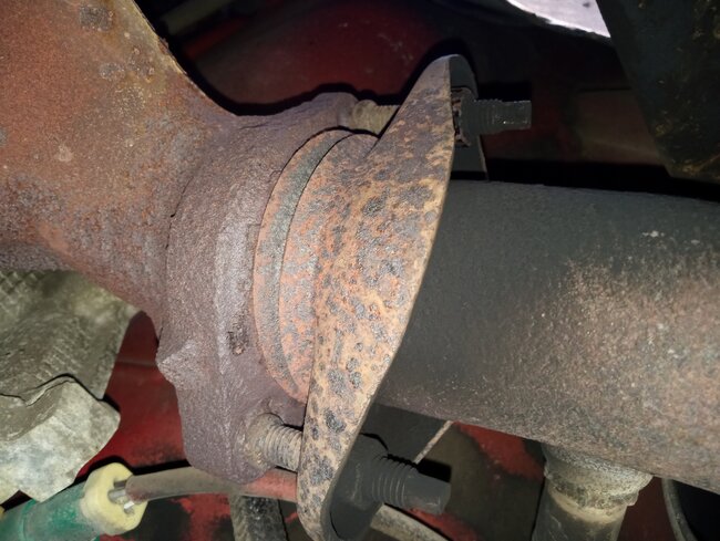

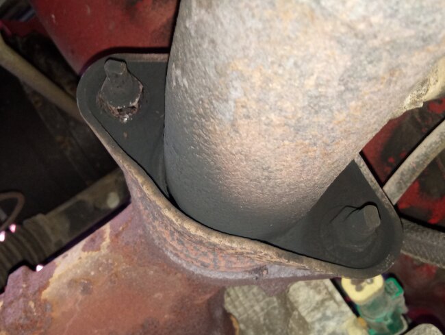

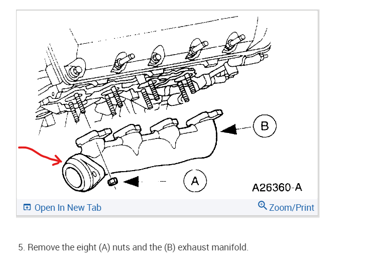

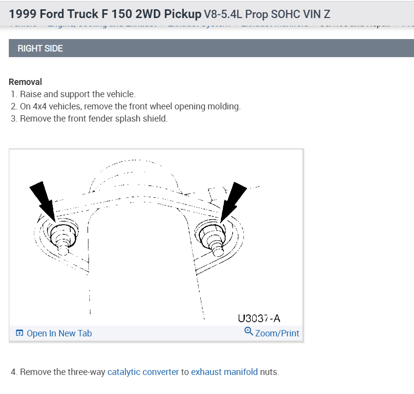

Thanks for the images they help. There is no donut like the older cars had, there is a bell made into the exhaust manifold that connects to the flange of the exhaust pipe. It looks like the exhaust pipe has broken and will need to be replaced by a muffler shop. Please check the images below to see what I am talking about; the nut size is 15mm deep well socket.
Feb 10, 2023 at 4:01 PM
MOUSE357
  • 58 POSTS

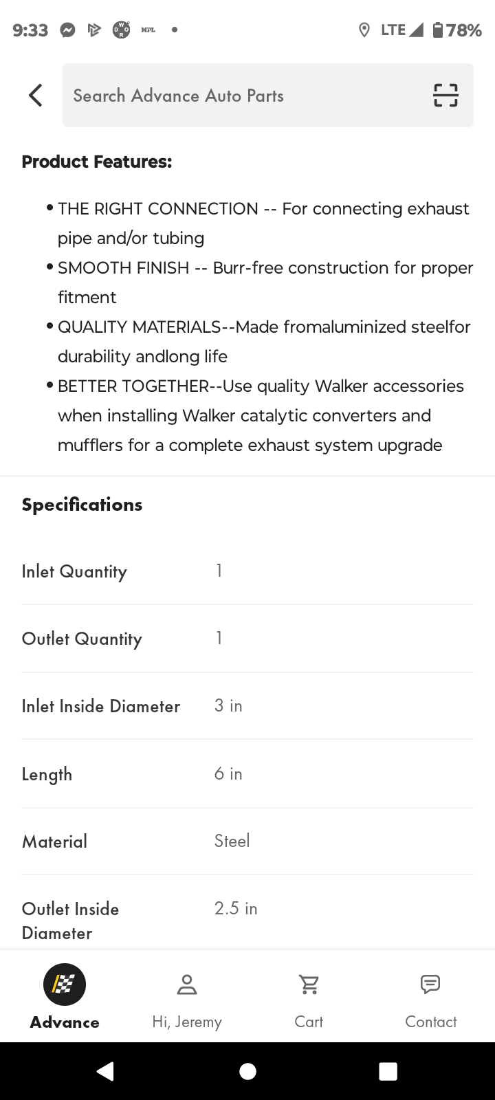

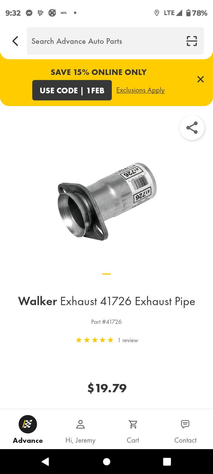

Now is there a way I can use this to replace the part that's broke?
Feb 11, 2023 at 6:35 PM
That is the part you need, it just needs to be welded in. good find.
