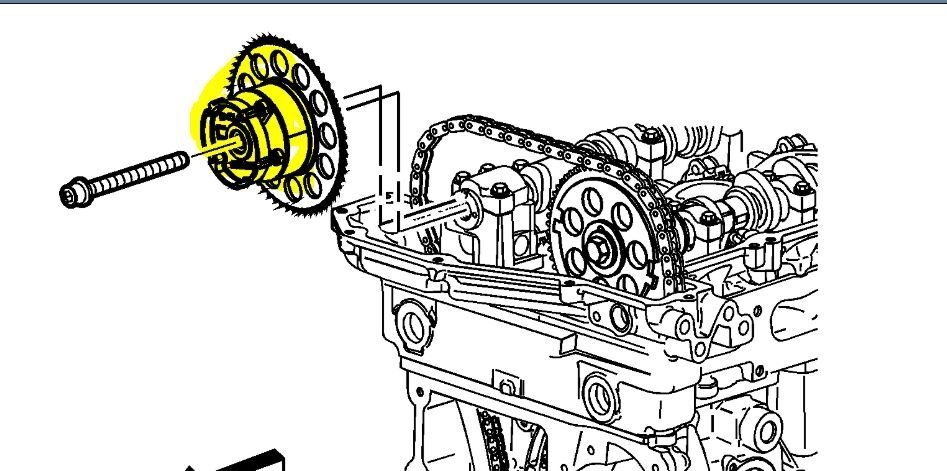

I attached a picture of the actuator so you can see what it is.

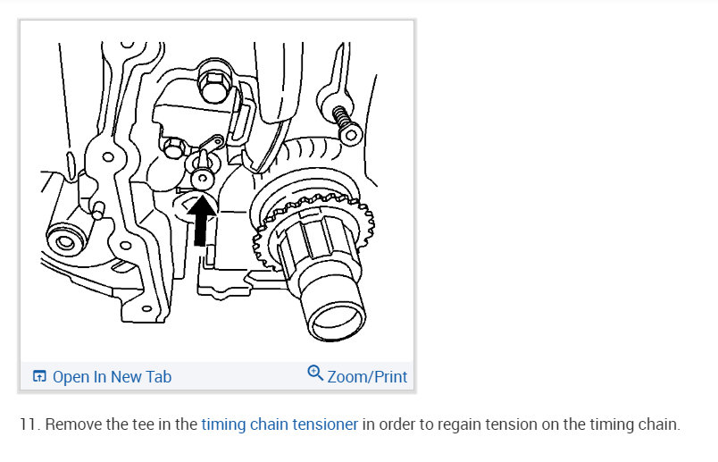

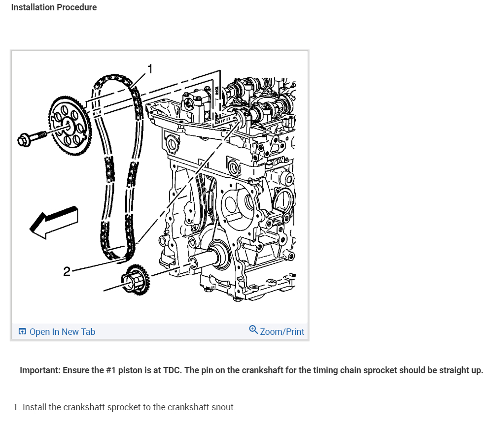

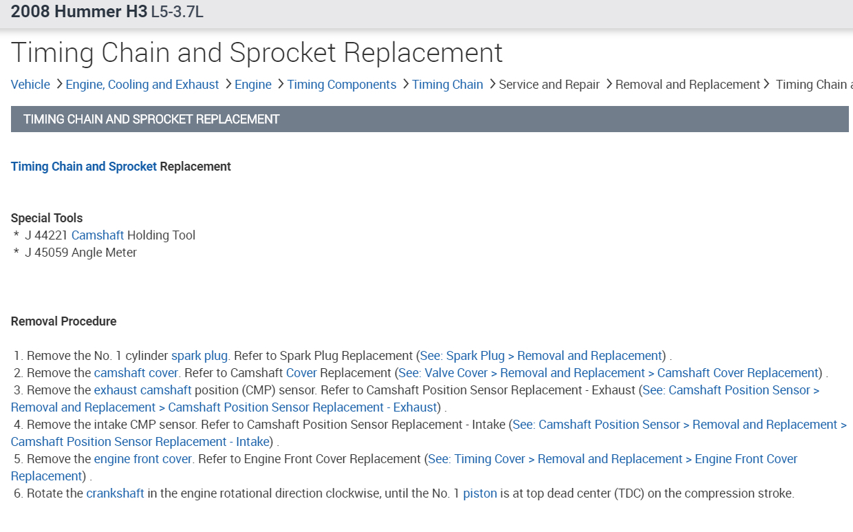

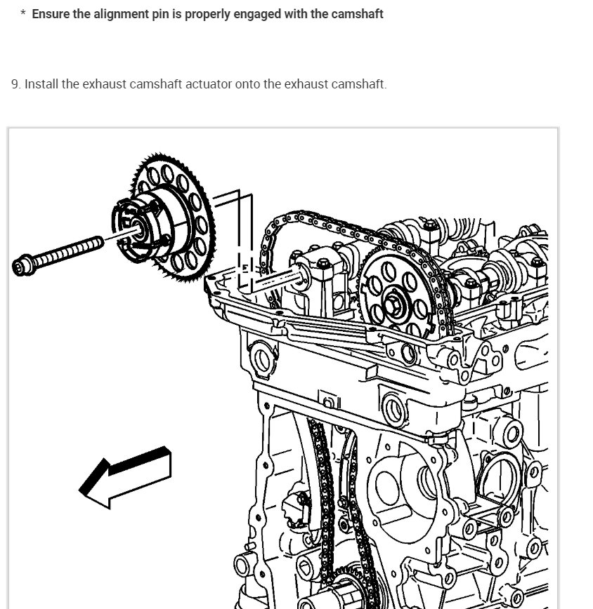

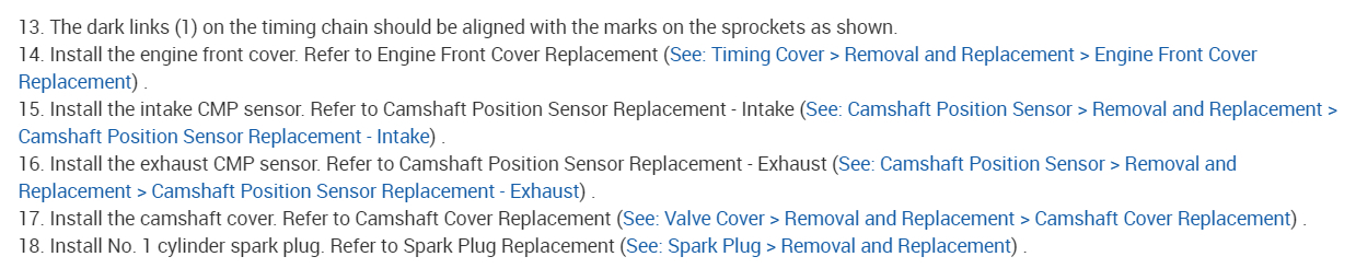

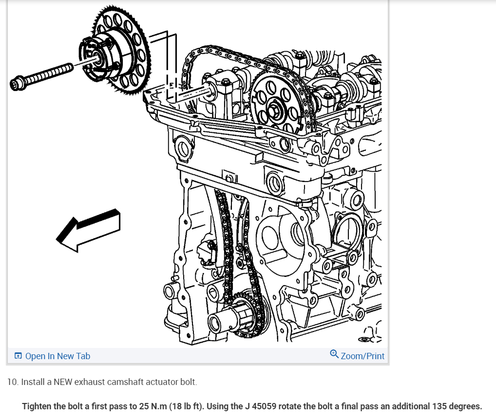

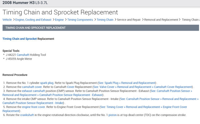

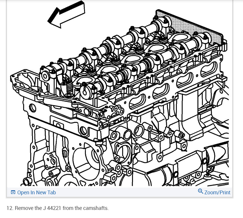

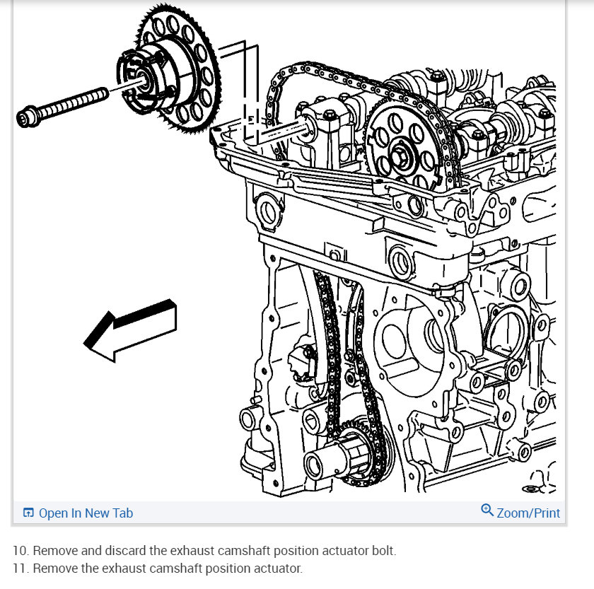

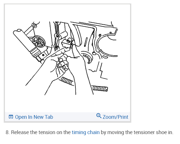

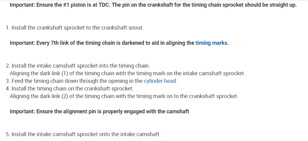

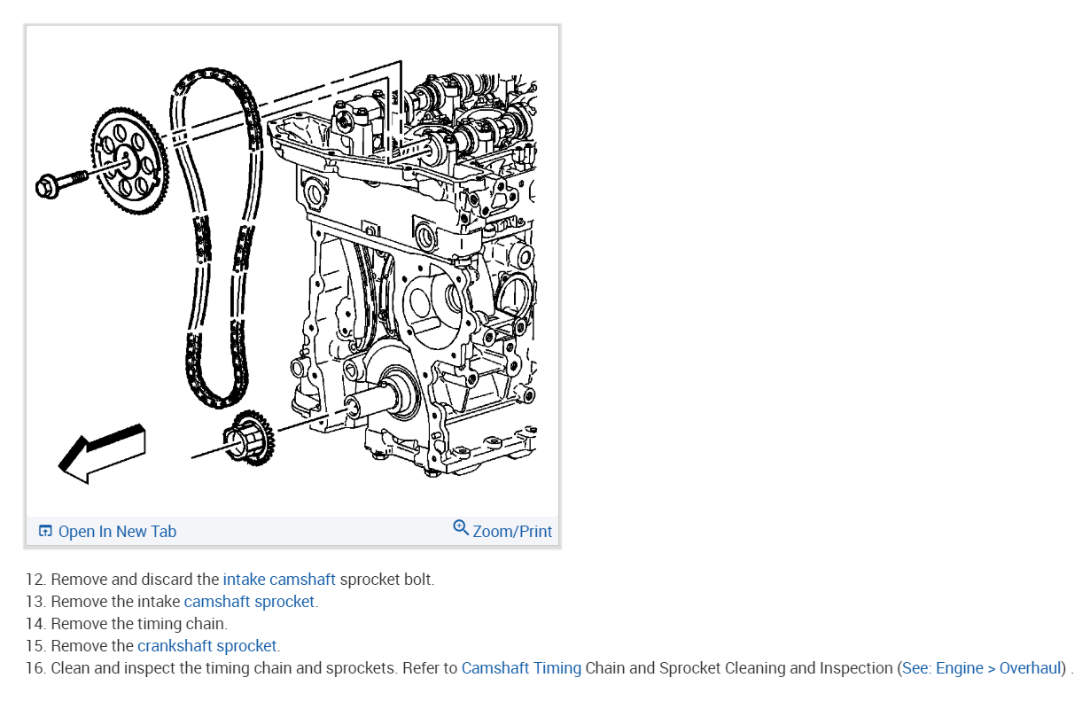

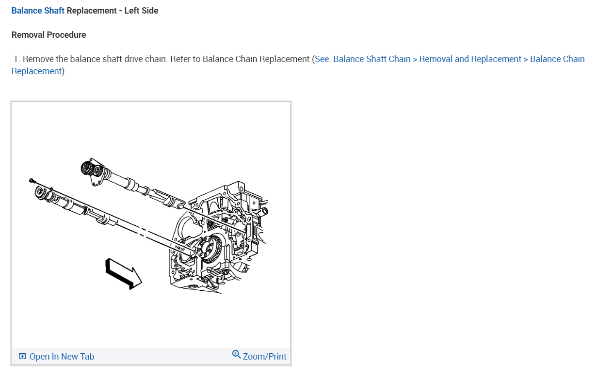

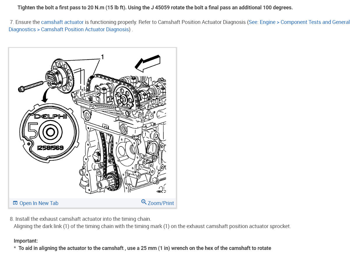

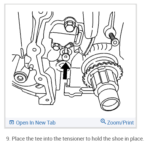

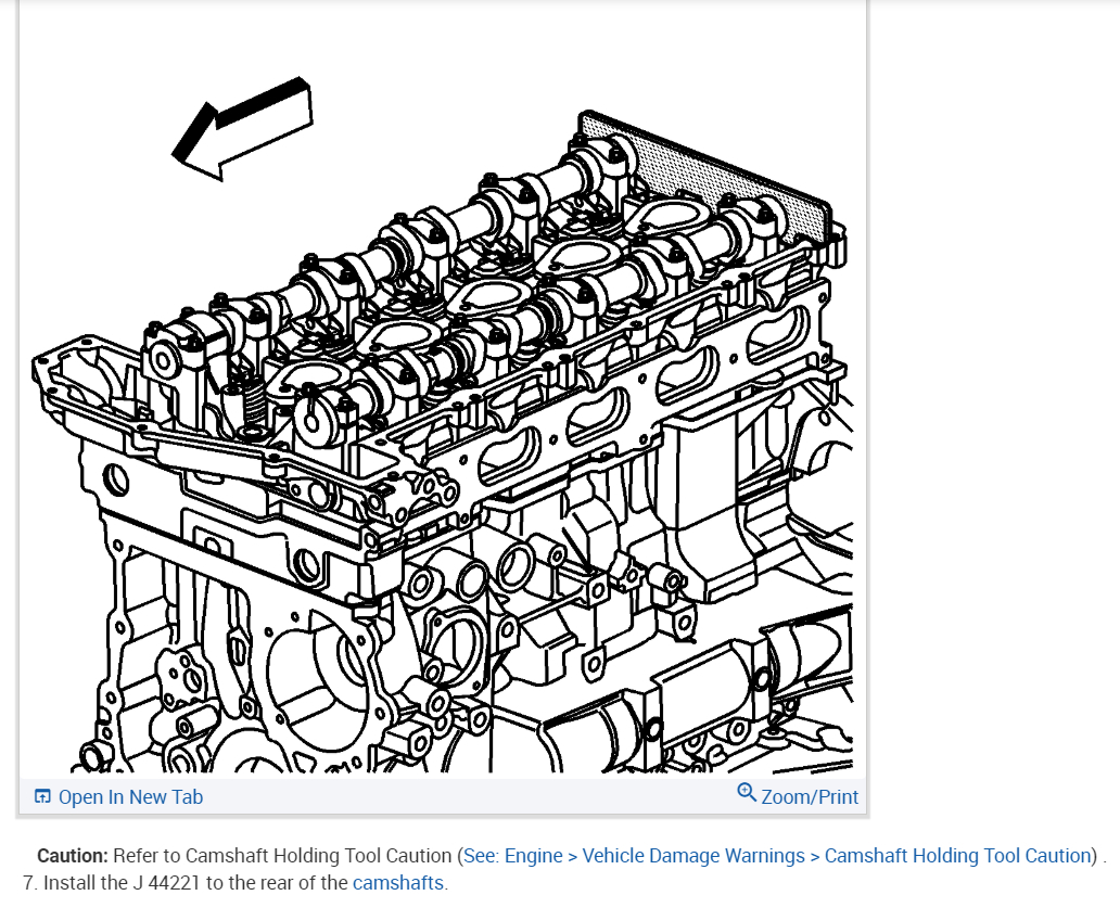

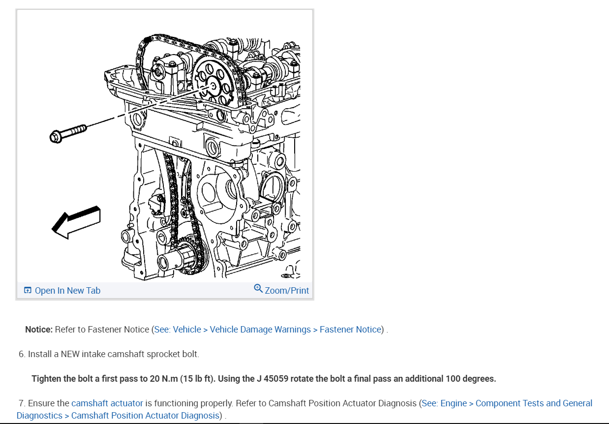

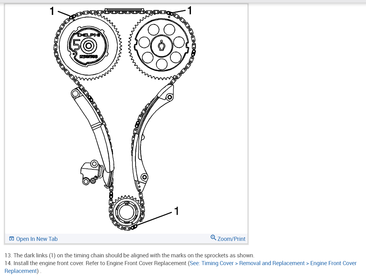

Hmm, It does sound like they messed something up which happens. Can you please shoot a quick video with your phone so we can hear the noise? that would be great. You can upload it here with your response. Here is the correct way to install the timing chain and actuators. Also these engines have balance shafts which have problems that make noise as well. Check out the diagrams (below). Please let us know what you find. We are interested to see what it is.
