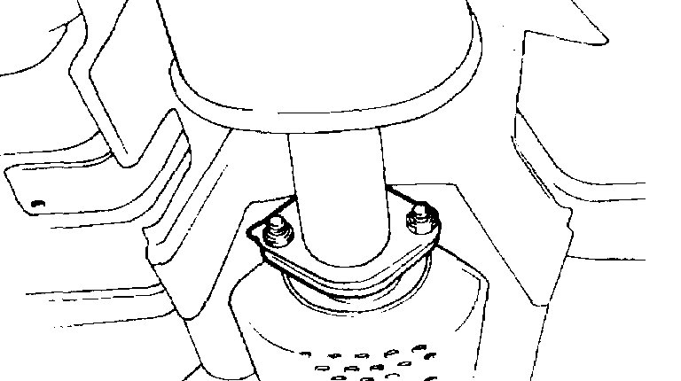

My car was fine yesterday and when i started to drive today my car is loud. I'm pretty sure it is my exhaust. Because it just happened can I just mend it or do I need to replace the exhaust?
Jan 16, 2019 at 8:53 PM
Honestly, it matters what the cause is. If something has come loose, most likely it can, but most times rust is the cause. I attached a picture that shows the system from the engine to the tail pipe (picture 1). Inspect the system on your vehicle and let me know where the leak is located. If you want to replace the system, here are the directions.

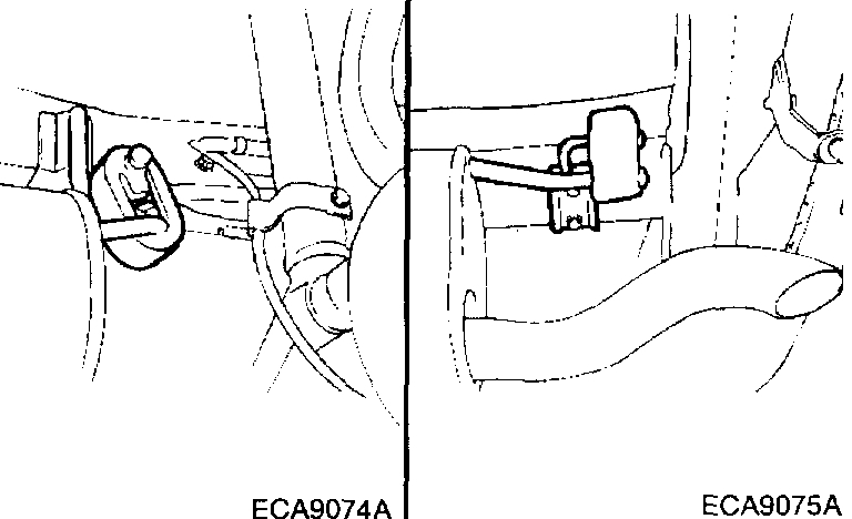

1. Disconnect the main muffler from the center exhaust pipe.
See picture 2
2. Remove the rubber hangers and take out the main muffler.

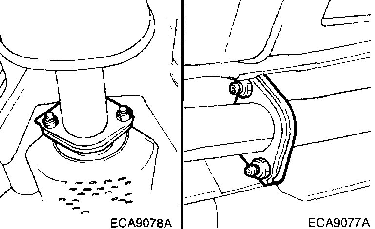

1. Disconnect the center exhaust pipe from the main muffler.
2. After disconnecting from the front exhaust pipe, remove the center exhaust pipe.

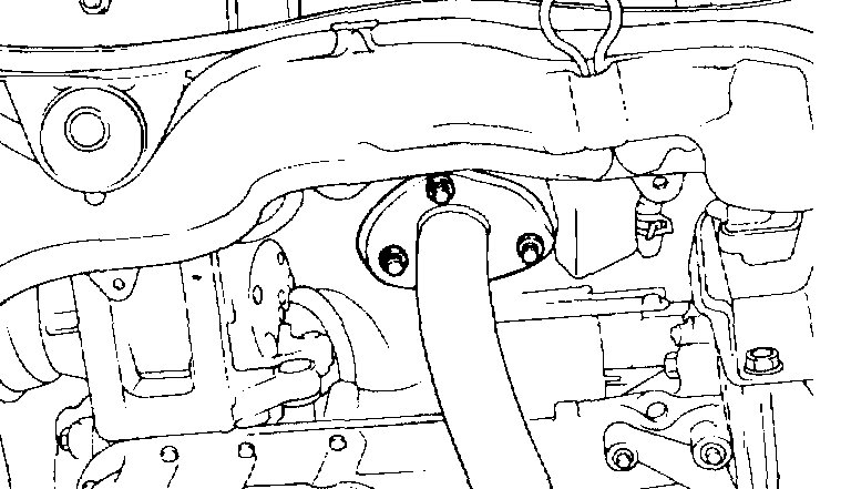

1. Remove the front exhaust pipe from the center exhaust pipe.

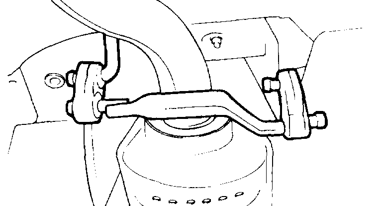

2. Remove the front exhaust pipe from the exhaust manifold (Including front catalytic converter)

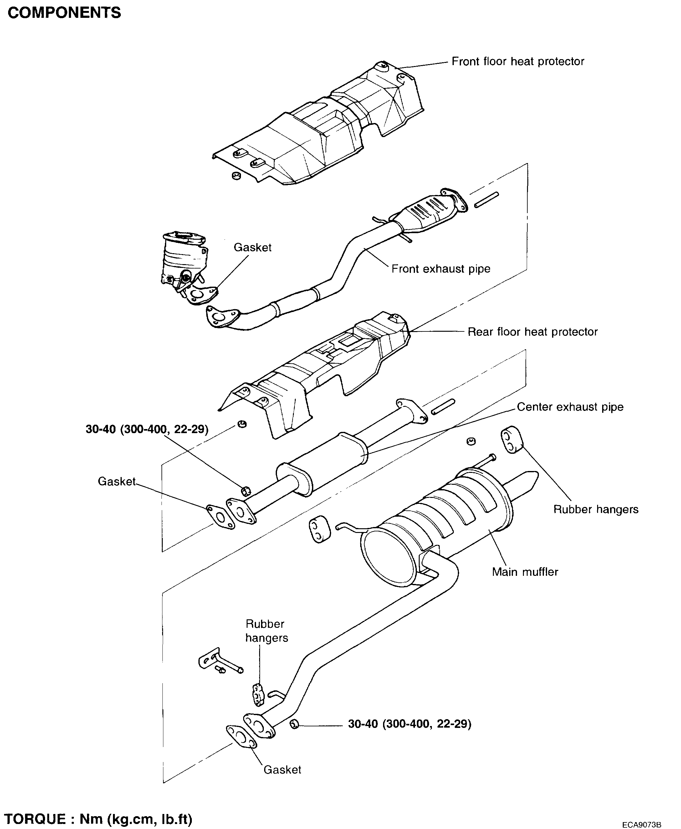

3. Remove the front exhaust pipe from the rubber hanger.

If you locate the leak, let me know where it is. Also, if you have other questions, let me know. I hope this helps.
