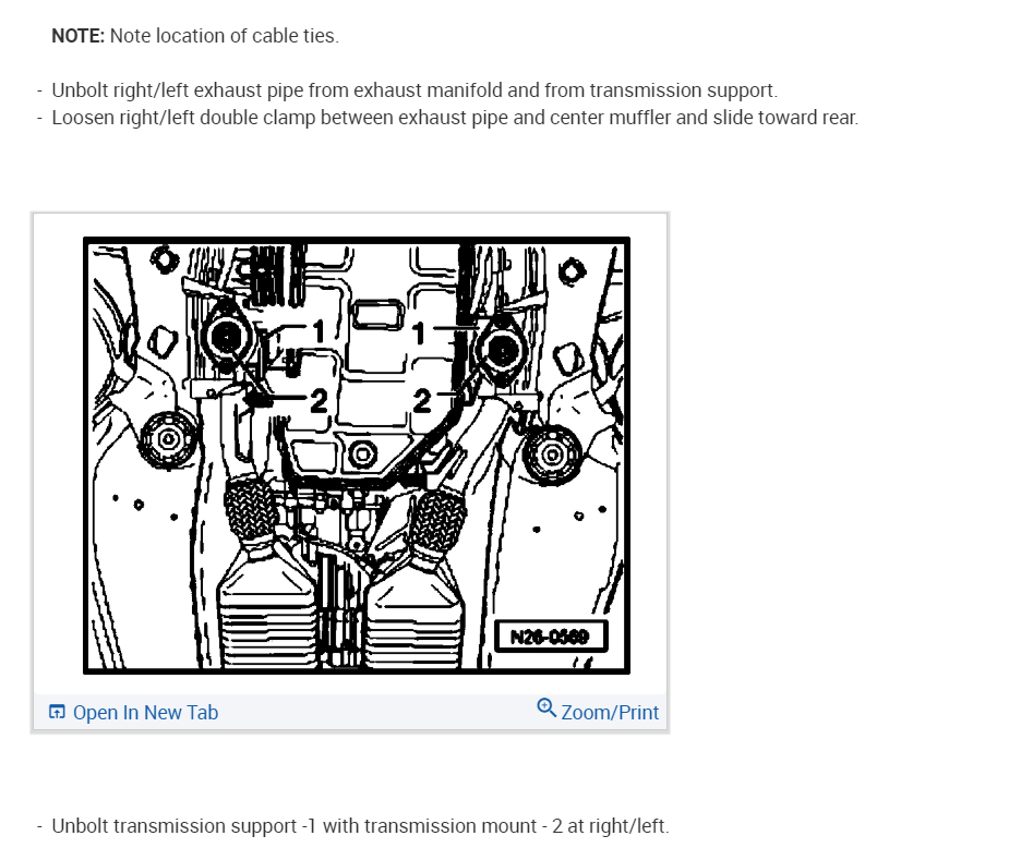

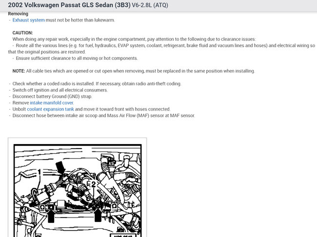

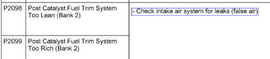

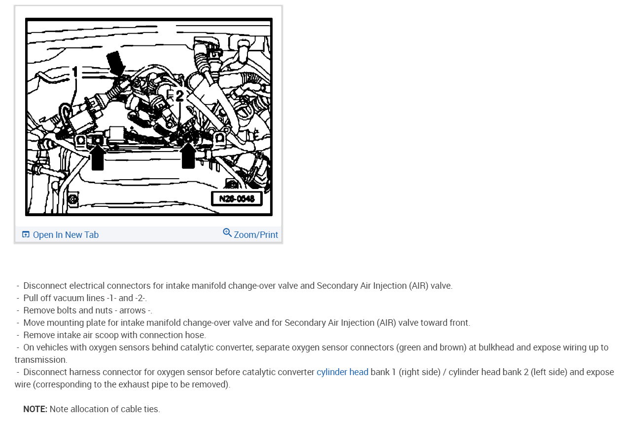

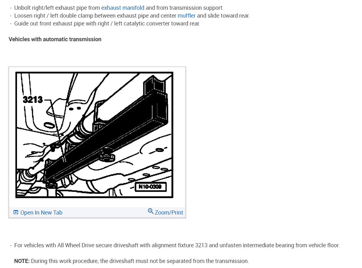

My car listed above GLX model, 2.8 4motion lost acceleration power and there is a sound behind the front drivers tire. it sounds like maybe there's a hole in the muffler. you can hear a putter sound. you place your hand in front of the exhaust and you can't feel anything coming out of it. there's no smoke or anything. I did get a code p2098. Could this be something with the flex pipe or a clogged catalytic converter or catalytic converter failure? I understand there's several things this could be. not sure where to start first.
