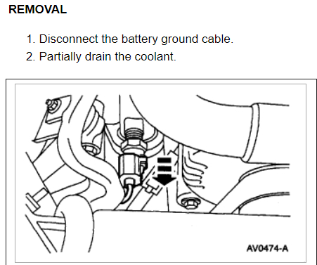

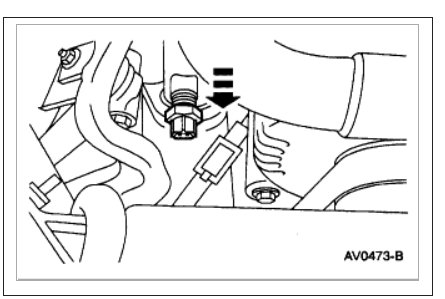

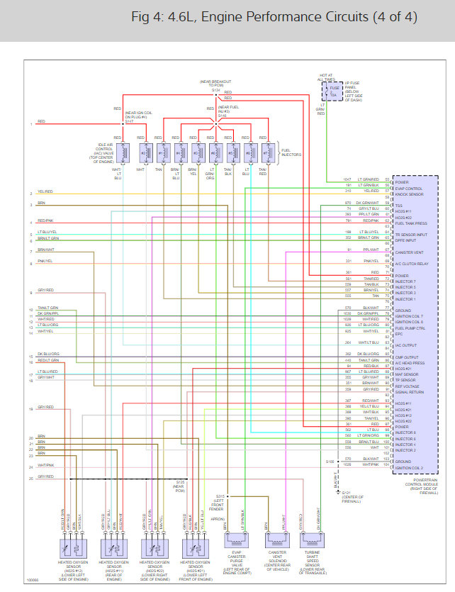

Anytime you have a temperature related issue I always lean toward the engine coolant sensor. Here is a guide to help you see what you are in for when changing the sensor out:
https://www.2carpros.com/articles/coolant-temperature-sensor-cts-replacement

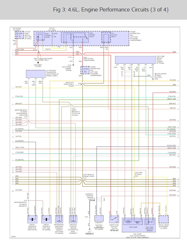

Also for the p0190 lets check the wiring.
May 13, 2018 at 11:27 AM
