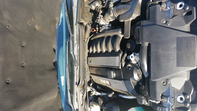

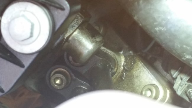

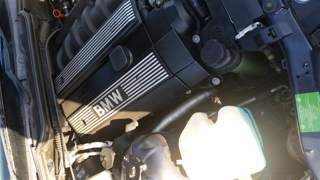

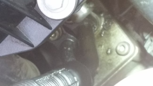

Oil leak on the left side, I cleaned it before and it has very slowly come back, I was told that the bolts down there are tighten enough so oil is coming through.
The smell started coming through after taking it to a mechanic and he did a standard service on it.
The smell is intermittent maybe happening once every few days and only smelt for a split second before disappearing again.
I have driven it 2000km and it is now needing a refuel on oil, dont know if thats normal
May 25, 2017 at 4:52 PM
It looks like from the pics that you have a valve cover gasket that is leaking and it needs to be replaced, here is a guide that will show you what you are in for when doing the job.
