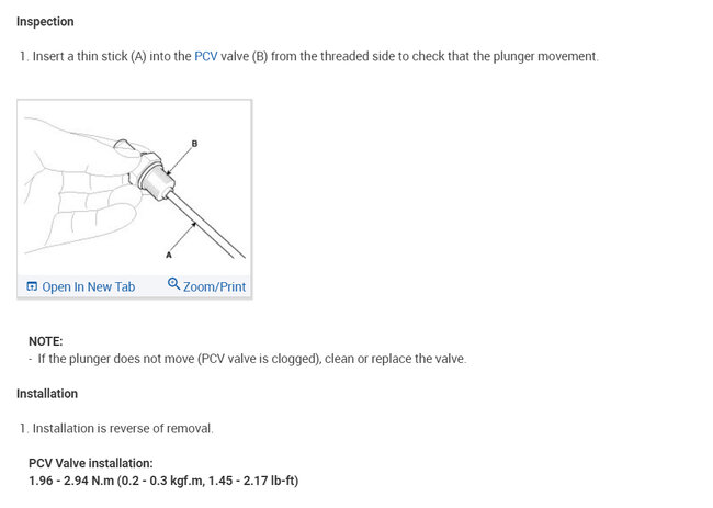

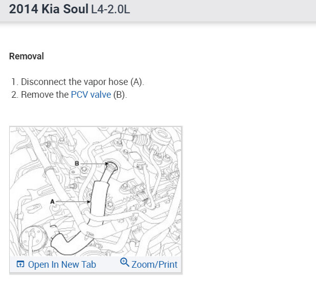

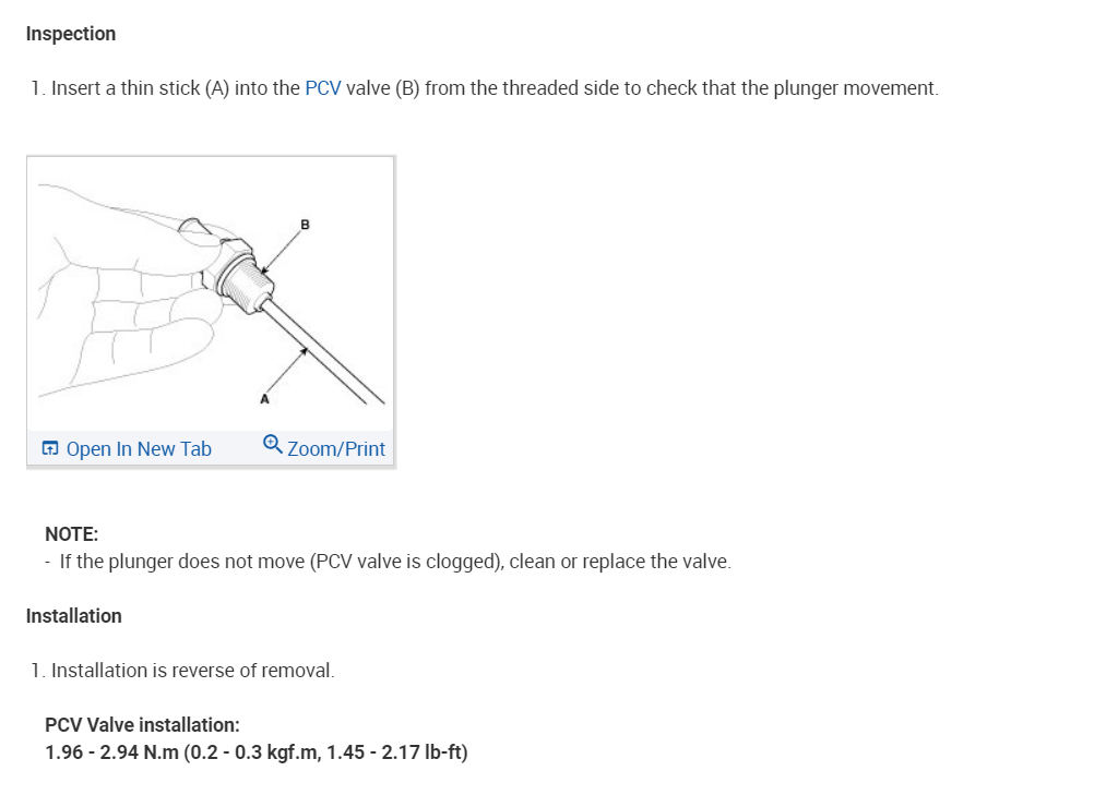

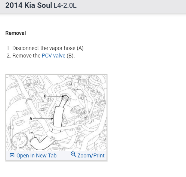

The oil consumption and gas pedal sounds don't seem like they are related. Can you please shoot a quick video with your phone so I can hear the noise? That way I can tell for sure what's going on. You can upload it here with your response. It seems like a vacuum leak to me and if so, please follow this guide when the engine is cold only. Do not spray the exhaust manifold:
The fluid is flammable so be careful. As far as the oil consumption I would check replace the PCV valve. Check out the images (below). Please let us know what happens.

Changed out PCV as you recommended. Better acceleration. Will need to monitor oil to see if there's a change in consumption.

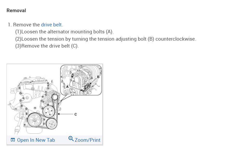

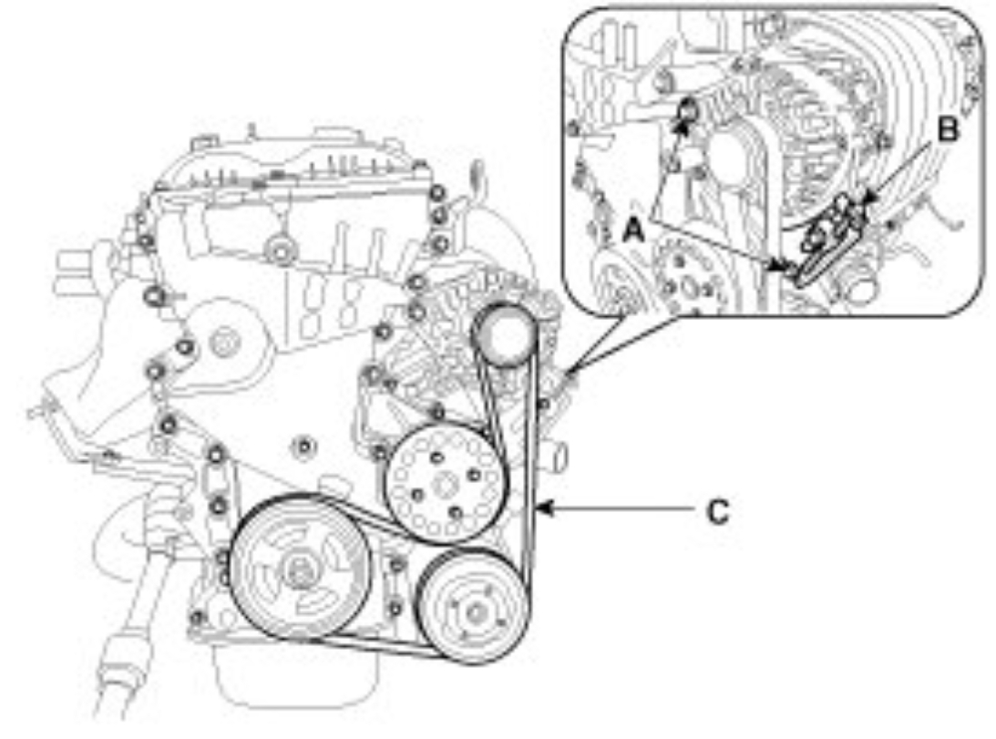

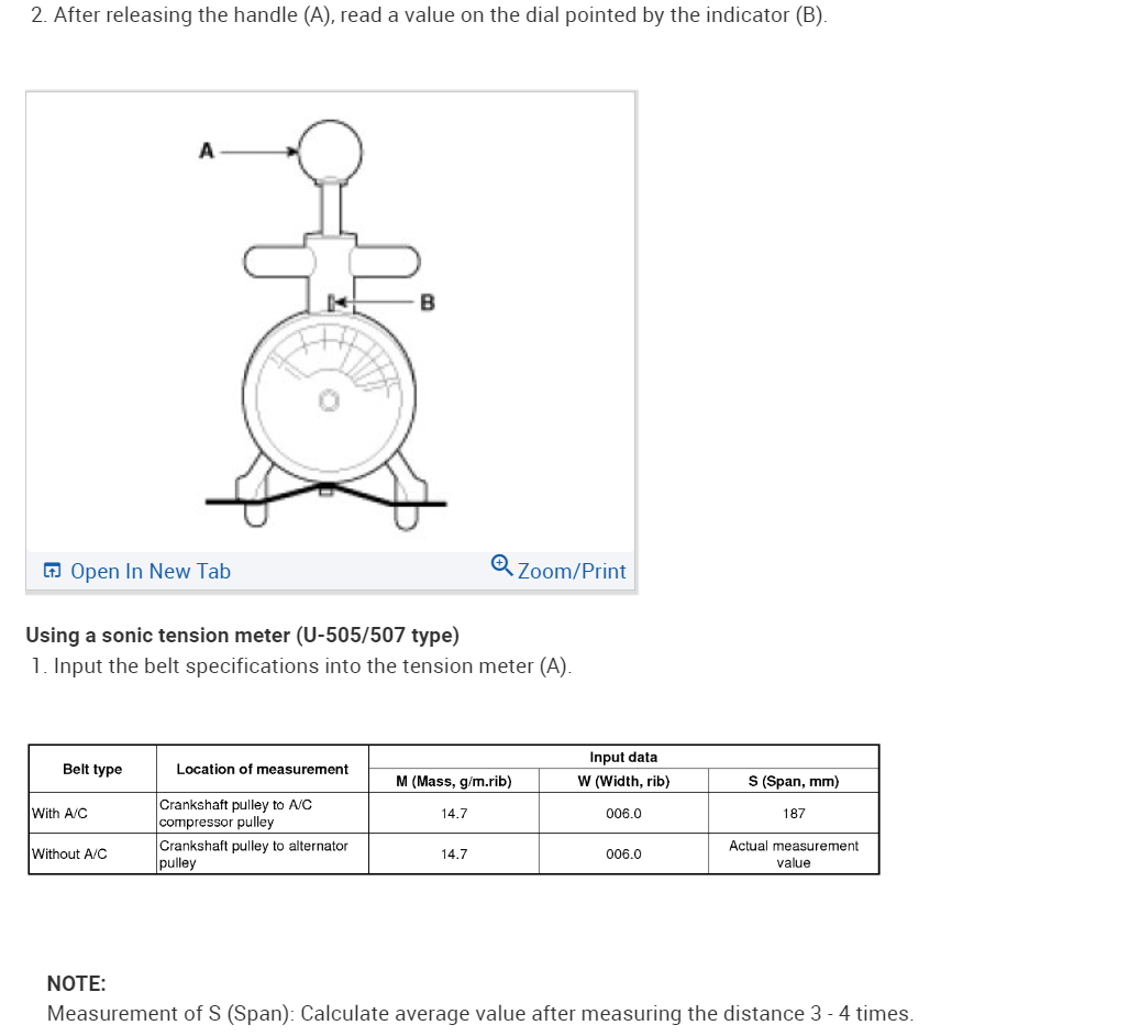

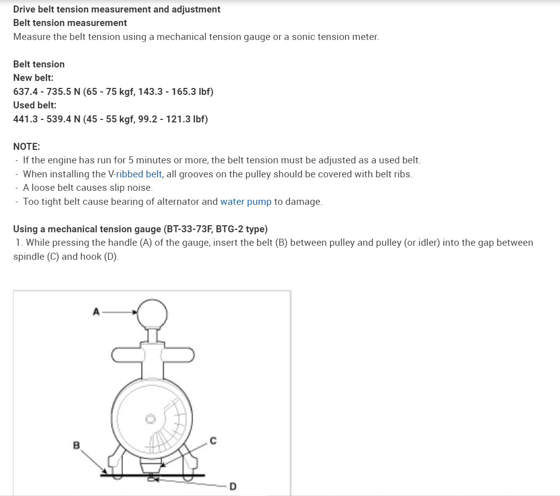

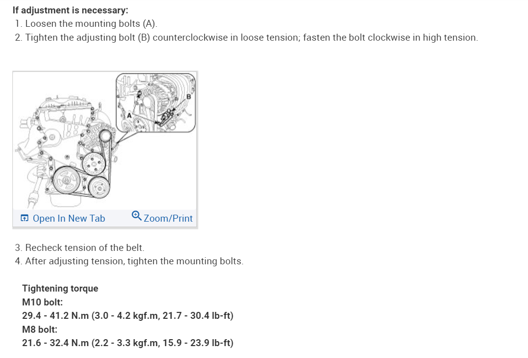

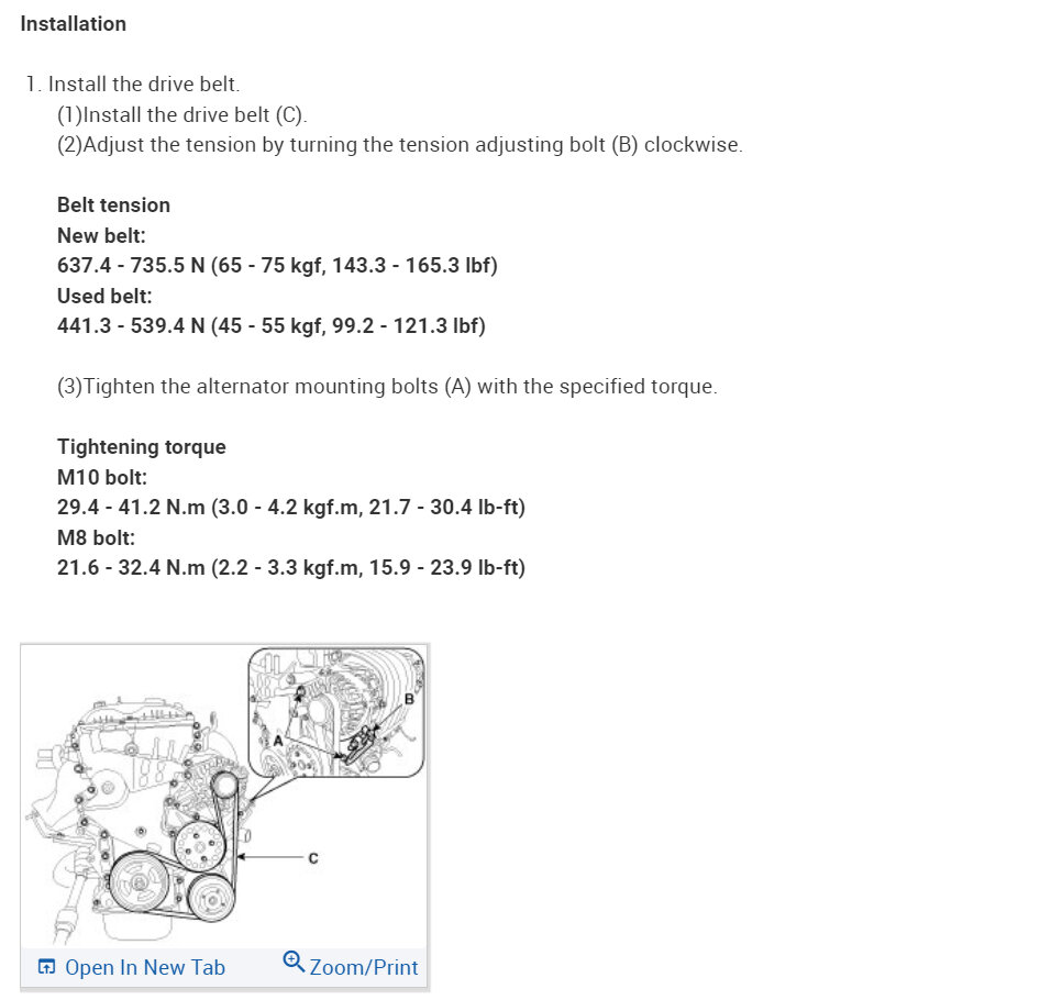

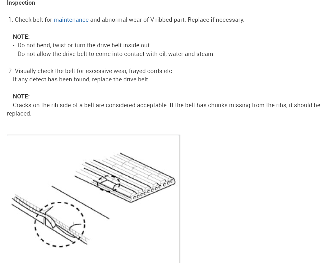

Interesting case, that noise has a metallic sound to it, like a bearing. Can you open the hood and rev the engine in Park and still hear the noise? Definitely sounds like a loaded bearing noise to me. If you can hear it with the hood open, and just raise the rpm in Park, I would remove the belt and see if the noise disappears, without the AC on its either the Alternator bearing or the Water Pump. If the noise is still present with the belt removed, then I would suspect a camshaft bearing.
I had a bad cam bearing once that sounded exactly like that, almost a belt noise, but it was in fact a camshaft bearing.

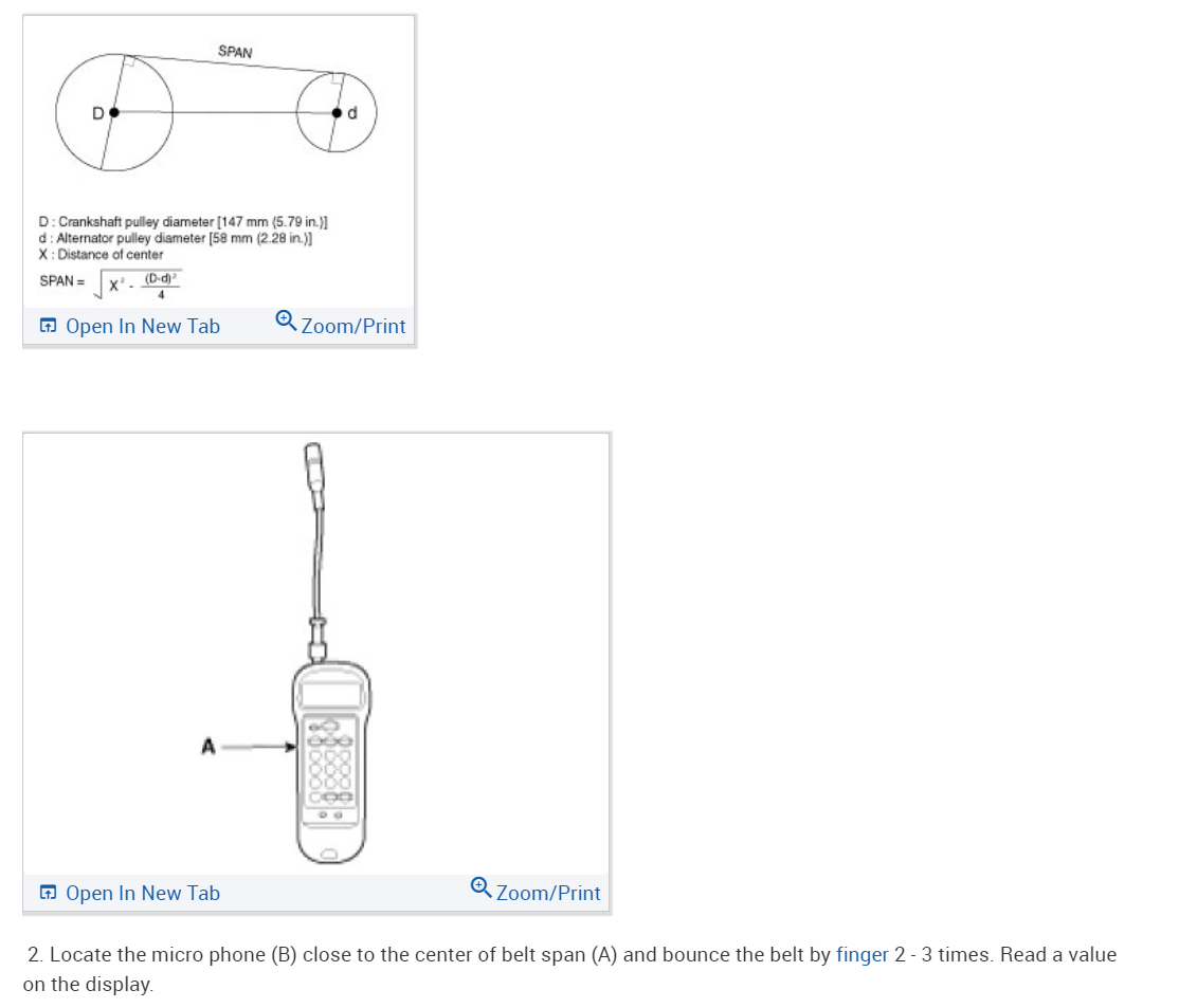

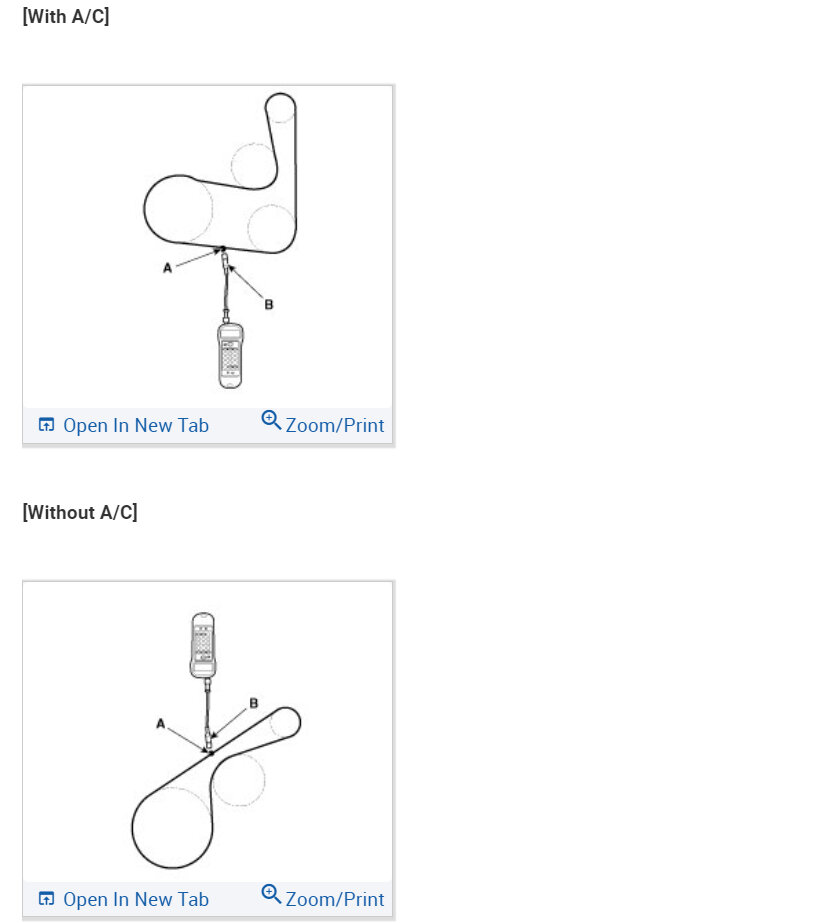

The belt on this vehicle has really tight tolerances. Never seen a belt with so many measurements involved.

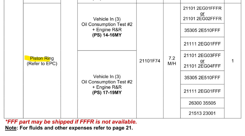

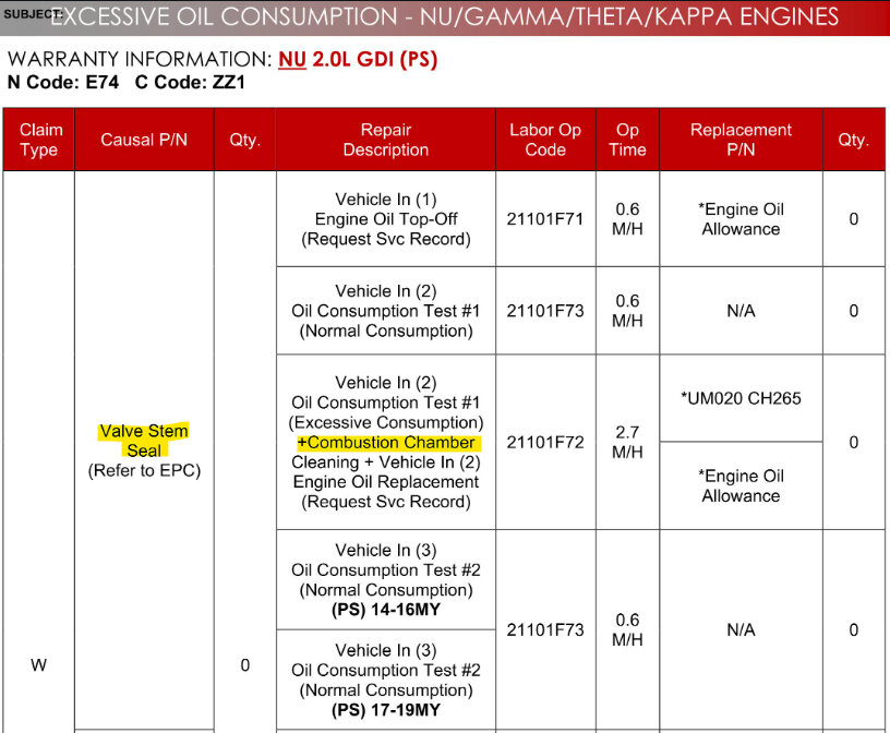

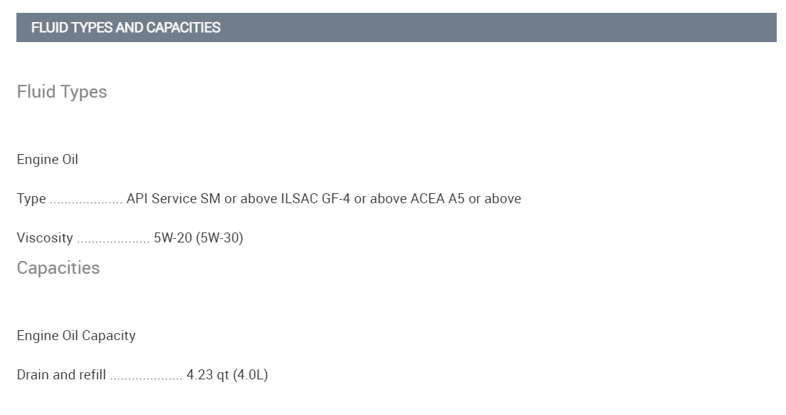

As for the oil issue, if there are no apparent oil leaks, there is a very long Technical Service Bulletin on excessive oil consumption. If it's more than 1qt in 1,000 miles, it is considered very excessive and there is a very extensive cleaning process, or engine replacement. It looks to be an in cylinder issue with the oil consumption, Piston rings, Valve Stem seals. The TSB (pgs 10,11) is a very long TSB about each step taken depending on the test results out of a 3-step testing process. But it looks to be a dealership issue that the manufacturer is aware of for such a long TSB on oil issues. The bearing noise and oil issue might be related in this case, The last pg below is the Oil specs.

Please test it before you replace it. As you say the car is using oil and that is a bad thing and could poison the replacement part. Repairing or at least determining why it is using the oil is the first thing to do. Then replace the converter if it is required. Take a look at the TSB on oil usage and possibly talk to a dealer about it. https://static.nhtsa.gov/odi/tsbs/2021/MC-10189272-0001.pdf
You may also want to look at
https://www.legalscoops.com/class-action-lawsuit-over-hyundai-and-kia-oil-consumption/
for some more reading on that engine and efforts to help owners of them.

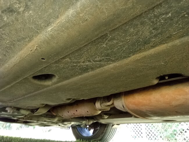

Hey Steve. Can you check this for me? Found a Catalytic Converter for a great price. It says it fits my car, but "placement" says "rear" mine is under front seats. Got a pic of under my car too.

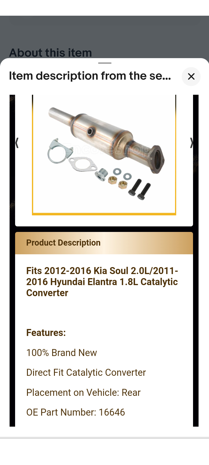

BOSTONBOATSWAIN
  • 45 POSTS
Hey Steve. Can ya check this for me. Found a CatConv for great price. Says it fits my car but "placement" says "rear" mine is under front seats. Got a pic of under my car too
Thanks
D.
May 6, 2023 at 12:34 PM

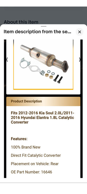

BOSTONBOATSWAIN
  • 45 POSTS

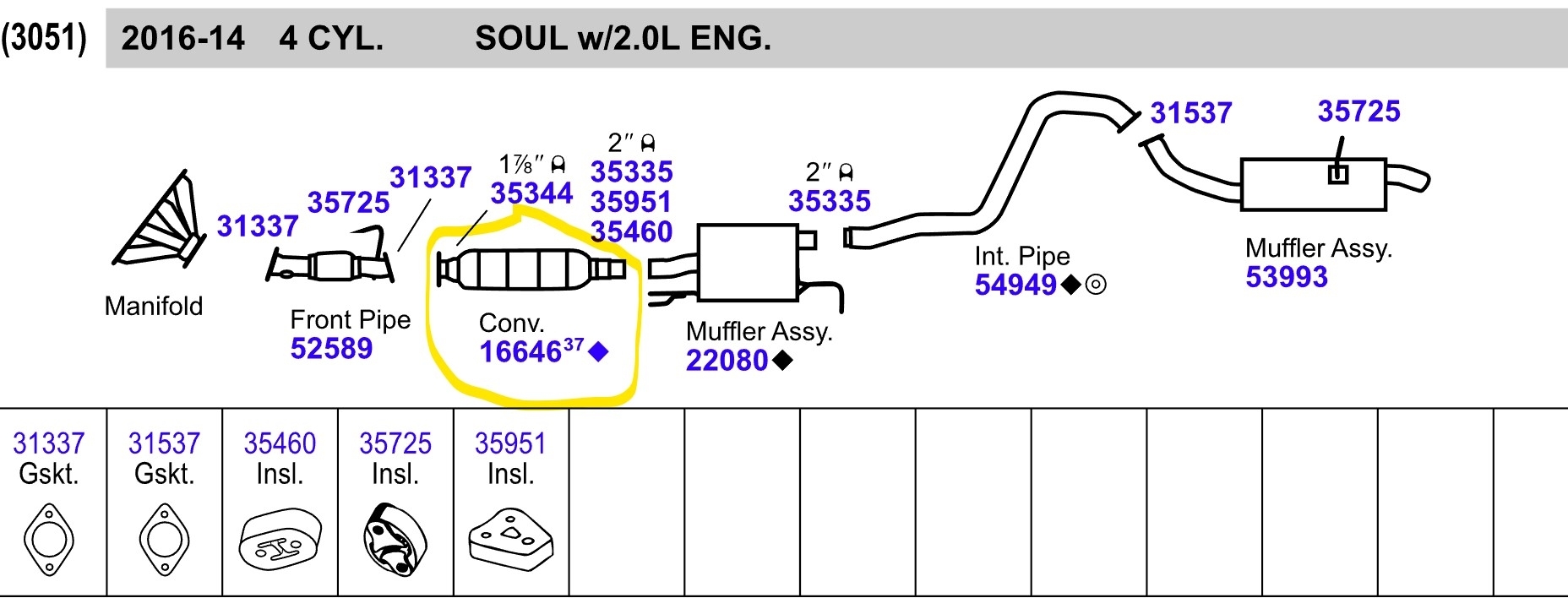

Maybe this one is a better fit? Confusing when they say "rear" as everything says I only have one and it's up front.
Thanks,
D.

STEVE W.
  • 15,113 POSTS
The confusion is due to the government. There are two versions of your car's exhaust, one that meets the California emissions and the other that meets the federal standards. Because of
that they name the converters based on location on the vehicle so if you have the ones like many new cars they are mounted right on the engine and are "front" converters, then ones under the vehicle can be center, or rear depending on the mounting location. In your case there is only the one, but they still like to make it confusing.
So, one step you need to take is look at the emissions standards your car was built to, there is a sticker on the radiator support or close by and if it says California anywhere on that sticker it's a Cali car. Now that is important in a couple states. NY and CA both have laws that say that if it's a CA standards car you have to replace the part with one that is CARB legal. Other states you can do what you wish at the moment.
You will also see ones saying that you cut as required, that is because the OE is a welded assembly so you have to take the new part and cut the old one off so the new one can be installed. So, all of the ones you show should work as long as you are not under one of those states.
Attached is an image of the exhaust for your car so you can see the pieces.
