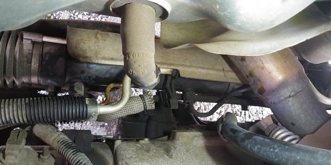

Okay, here's a picture of it. Let me ask you this. Is there a pan like that the condensation from the A/C drains into? That if the heater coil is leaking it could leak into that pan and drain out that hose? Also when I went over to my friends house yesterday to take the picture the water had all leaked out of the reservoir over night with the car just setting there.
Aug 30, 2020 at 9:36 AM
That does look like the condenser drain. In all honesty, no, coolant shouldn't get into that portion of the HVAC system.
If you lost coolant overnight, here is what I suggest. You need to pressure test the cooling system. You will need a pressure tester, but most parts stores will lend one to you.
By doing this, you should be able to see where the leak is coming from. Follow this link and let me know what you find:
https://www.2carpros.com/articles/radiator-pressure-test
If coolant starts leaking from the hose in the pic (A/C drain) we need to take things apart to see what is happening.
