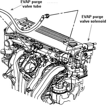

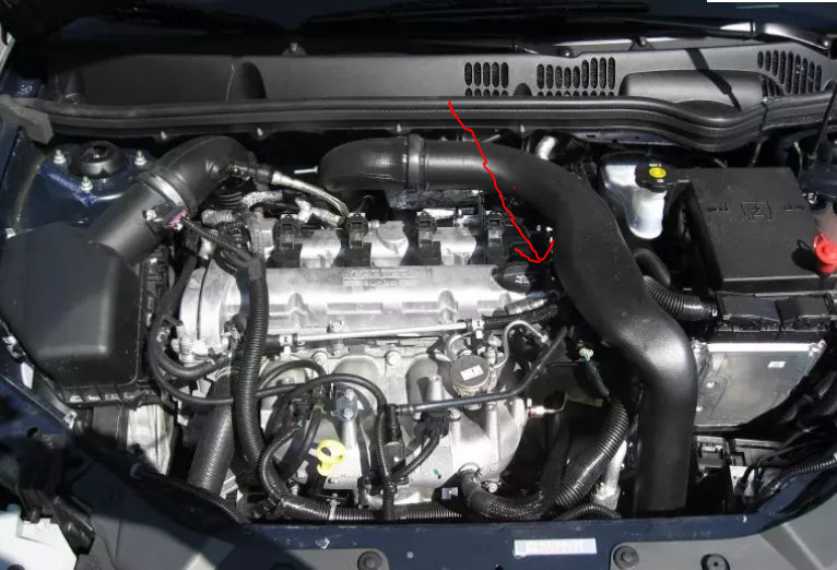

Having a problem with the Evap vent sensor, and where is it located?

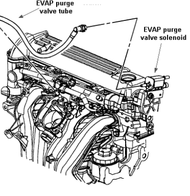

The EVAP purge solenoid is located under the hood, on the right side of the engine (if you are facing the engine).
I have attached diagrams below for your reference.
Thank you.

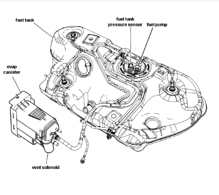

The vent valve is it on the evap,? If so where is it located?

The EVPA canister is located on the top of the fuel tank.
See attached diagram.
Thank you.
