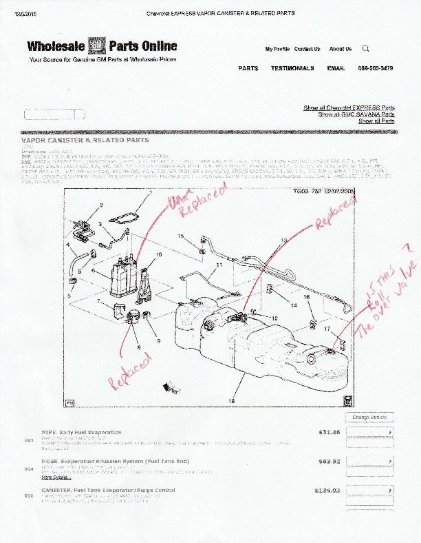

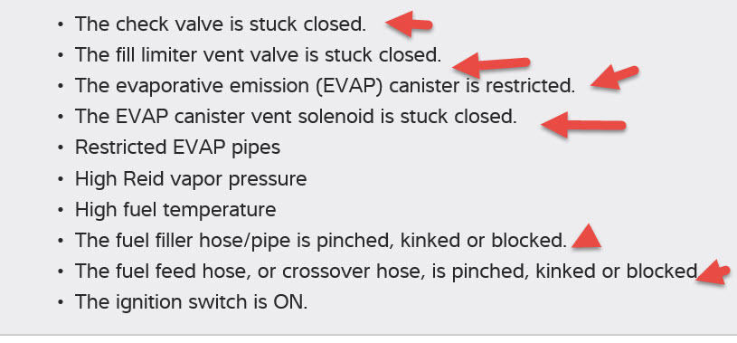

I have a motorhome with a chevy express chassis. Tried to fill tank and the gas came right back out. Took it to a repair shop and had purge and vent valves replaced. Repairs made no difference and still can't fill the tank. Any suggestions?
