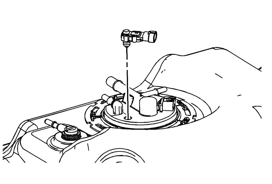

There is no EVAP sensor, there is the EVAP system that uses multiple parts to test the system and detect leaks. If it determines there is a leak it then sets a code. Those parts are the fuel tank and lines, the EVAP purge and vent valves as well as the charcoal canister leak detection pump and the fuel tank pressure sensor. I'm assuming you have a code set? What is the code? That would give us a starting point as to where to look.
