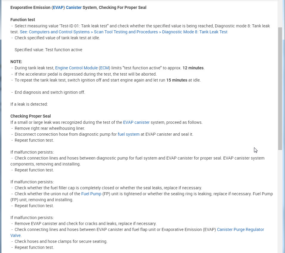

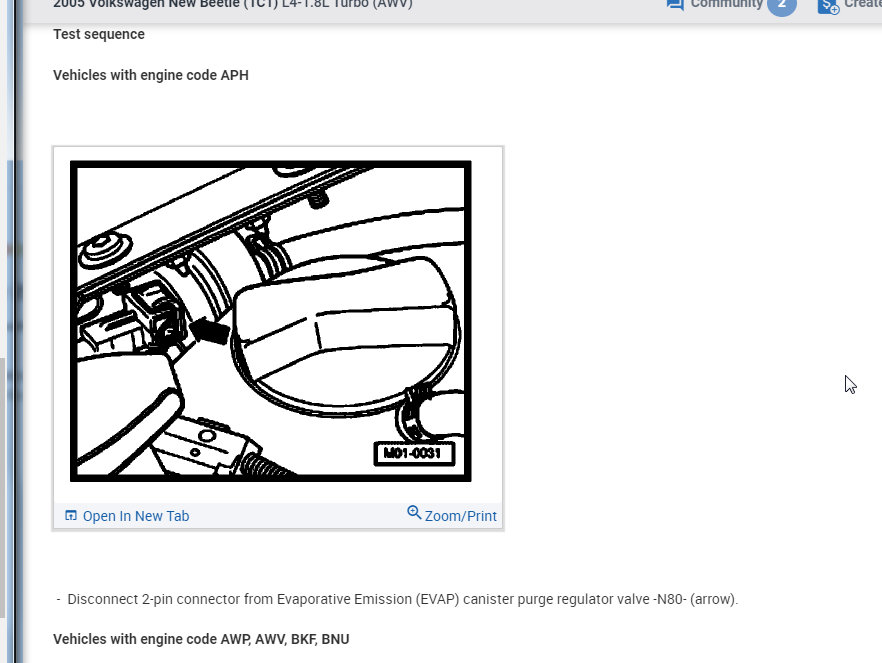

Does anybody know why my bug is burning through gas so quick?
It’s a 2005 1.8l turbo and I’m using premium gas.
It’s throwing a p0455 code (EVAP large leak).
it’s not the gas cap, the mechanic smoked the lines out and can’t find a leak, he check the purge valve i think is what he called it. Can’t figure it out!
Also I can watch the gauge drop an entire notch and then go up a little bit and drop again. It’s moving around weird.
I’m going nuts!
Getting 10/15 MPG.
