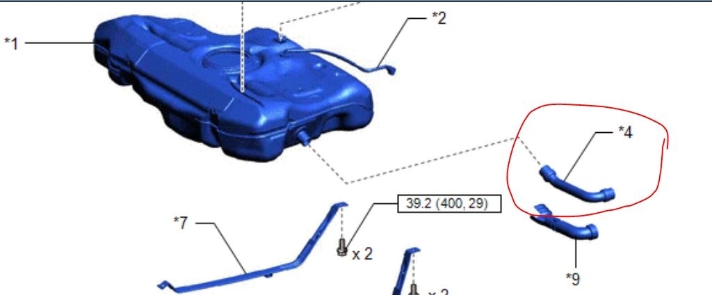

The codes indicate a large EVAP leak, so what they are telling you could be correct. The filler tube that connects to the fuel tank may have been hit or damaged. Did you hit anything on the underside of the vehicle? Was it involved in any accidents?
What I have done is attached a exploded view of the fuel tank. I circled the filler tube which they are referring to. Take a look under the vehicle and locate the tube, then check to see if there is any damage to it.
Let me know what you find.
