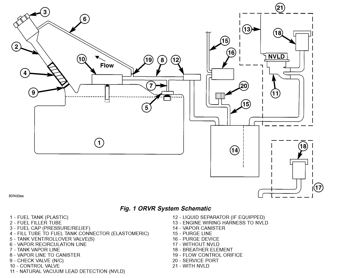

Below is a guide to help you see how the system works.

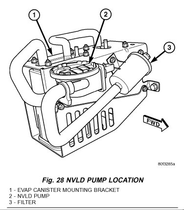

Smoke should not come out of the system at all it is closed. When you say leak detection pump I do not see it in the diagram above. Can you take a picture and upload it so I can see what you are talking about?

Smoke shows coming through the air filter connected to the pump. I believe #18 in your diagram (breather). #3 in my picture. I agree that the system should be closed.

Good find on the diagram I would say the pump is bad but I think I would try to get a used unit because they don't go out that often.
