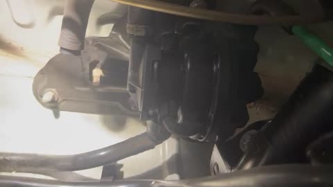

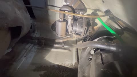

I fixed a leak from a hose connected to the secondary air pump seems to have helped my fuel trims, I think. I smoked the system from the Evap hose in the front next to the fuel line and saw smoke come out of the right rear well. I took off the well cover and smoke was coming out of the leak detection pump filter with the car off. No other signs of smoke coming from anywhere else. Isn’t this system supposed to be closed off until activated? I removed the filter and plugged it with a rubber plug, smoked again, no smoke coming from anywhere else. I removed the smoke machine hose and plug, and it sounded like a lot of pressure was being released.

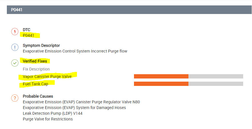

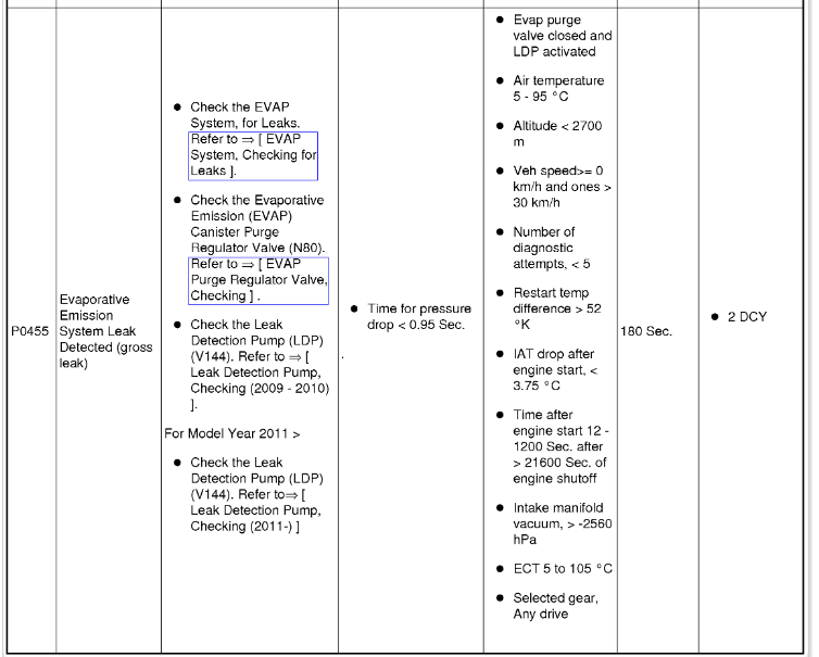

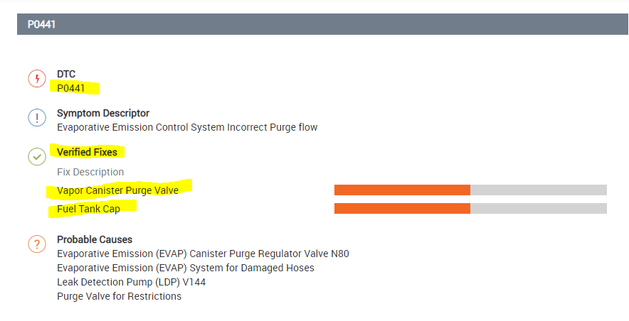

As far as the P0455, that is identified as a large leak. If you clear the code, does it return? Is the fuel cap sealing?

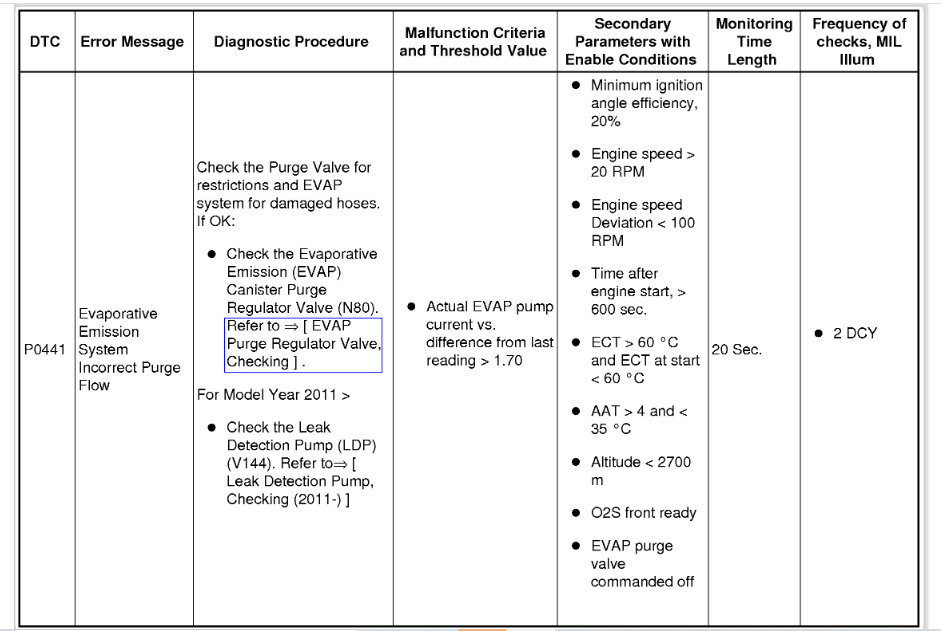

As far as the P0441, that is also related to the EVAP incorrect purge. The two most common causes of this code are either a fuel tank cap or the vapor canister purge valve.
Have you checked either of these items? Take a look at the pics below.
See pics below.

Joe, thank you for the quick reply.
Only did a visual inspection on fuel cap and it seemed fine.

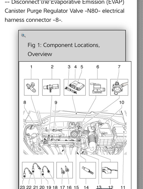

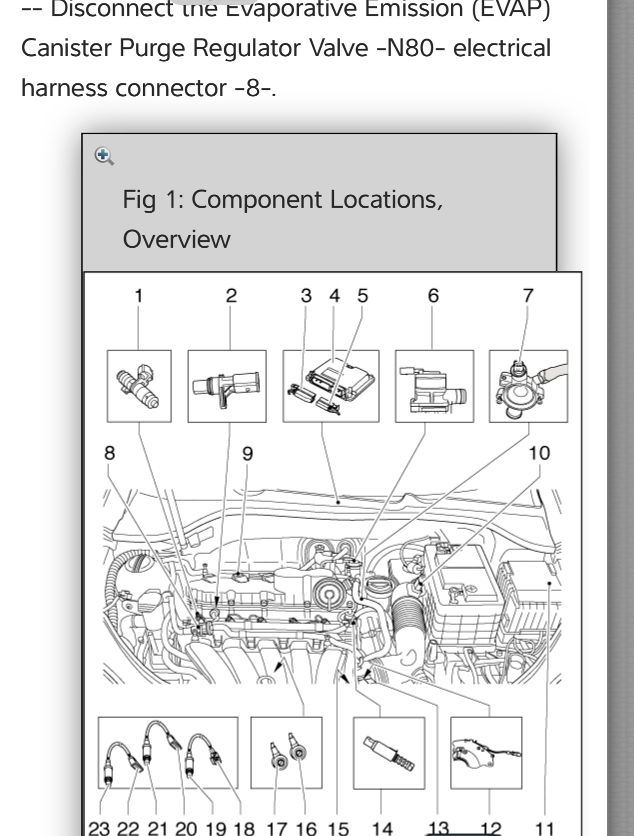

In the image I’m providing below I checked figure 8, canister purge regulator valve, I think we might be talking about the same one. Anyway, I activated the solenoid a few times by jumping battery power to it. The harness had battery voltage within spec. And solenoid resistance it was within spec.
I didn’t check the purge valve to intake side for smoke leaks though.
