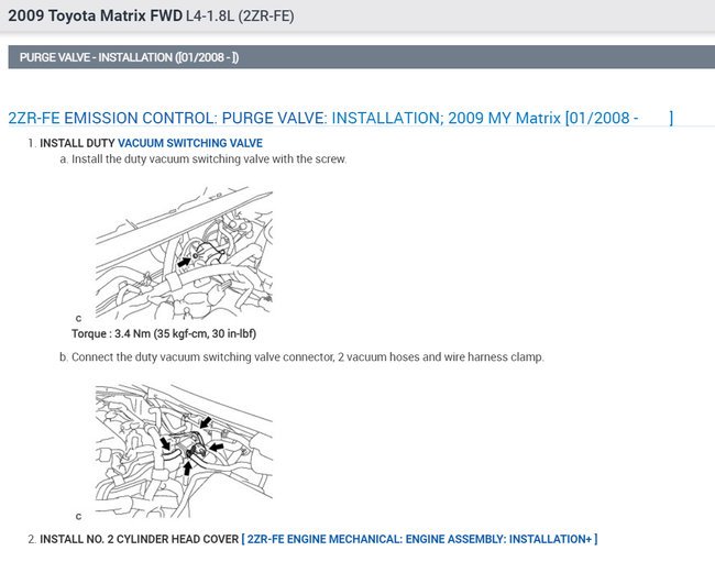

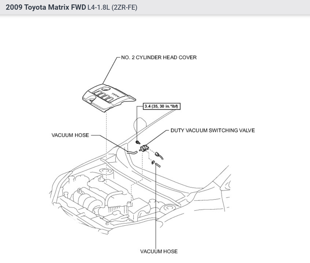

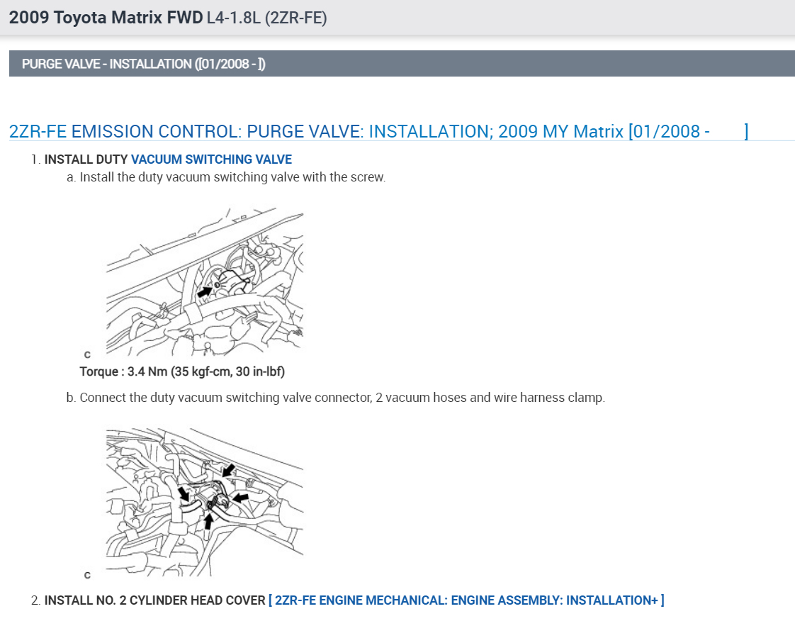

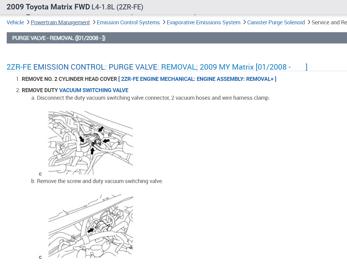

This sometime happens and these codes when the EVAP purge control solenoid stops working. Also, check the vacuum line going to and leaving from the solenoid here is the location so you can check it out. Check out the diagrams (below). Please let us know what you find. We are interested to see what it is. If you find something clear the codes to see if it comes back.

Good job, yes remove the solenoid and supply it with 12 volts and a ground and the solenoid should click, if not it is bad.
