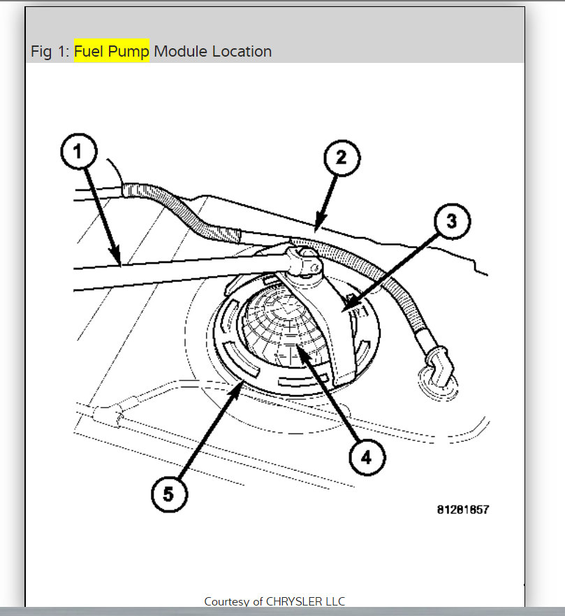

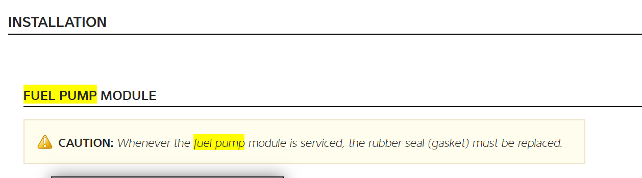

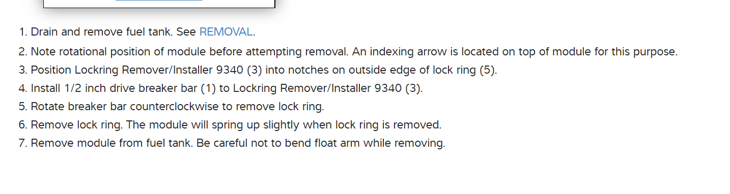

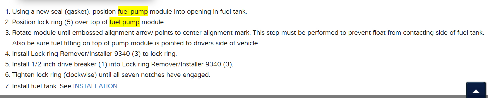

The fuel pump on your vehicle is held in place with a lock ring that goes on top of the fuel pump and pushes and holds it in the fuel tank. There is a gasket that goes under the lock ring and seals the fuel tank. It is possible that this gasket has failed, and that is why there is a strong fuel odor. This would also account for your small EVAP leak. In the diagrams below I have included instructions for the removal and installation the fuel pump for your vehicle. Just use the parts for removal and installation of the lock ring with a new gasket of course. Please get back to us with what you find out.
