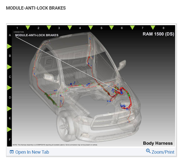

ESC light stays on checked the sensor that the dealership told me to check light still on code is C121D.
Sep 14, 2022 at 11:34 AM
The C121D code: The Anti-Lock Brake System (ABS) Module monitors the Brake Pressure Sensor. Is the brake fluid full? This sensor is inside the ABS module so to fix the issue is to replace the ABS module. here is the location and how to do the job, so you know what you are in for during this repair.
REMOVAL
CAUTION:
When removing ABM from HCU, be sure to completely separate the two components (approximately 38 mm (1.5 in.) before removing ABM. Otherwise, damage to the pressure sensor or Pump Motor connection may result requiring HCU replacement. Do not to touch the sensor terminals on the HCU side or the contact pads on the ABM side as this may result in contamination and issues in the future.
Remove the negative battery cable from the battery.
Pull up on the ABM harness connector release and remove connector.
Remove the ABM mounting bolts .
Remove the pump connector from the ABM.
Remove the ABM from the HCU .

Yep, how do the brakes seems to work? If okay then this leaves the ABS control module that needs to be replaced. Let me know what happens please.
Sep 15, 2022 at 8:57 AM
MANDY LYNN EDWARDS
We found out exactly what it was, its the hcu and ABS module
Sep 15, 2022 at 9:39 AM
